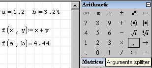

Here is the example of the Regional Settings when comma is the function argument separator and point is the decimal separator
comma
These settings are mainly used in the English part of the wiki.

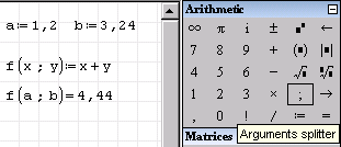

For many European languages, the SMath could be used with semicolon as the function argument separator and comma as the decimal separator
comma
NOTE: There is also a possibility to change the function argument and decimal separators without leaving SMath. You can change it from Tools=>Options=>Interface dialog box. There are Decimal symbol and Arguments separator options.

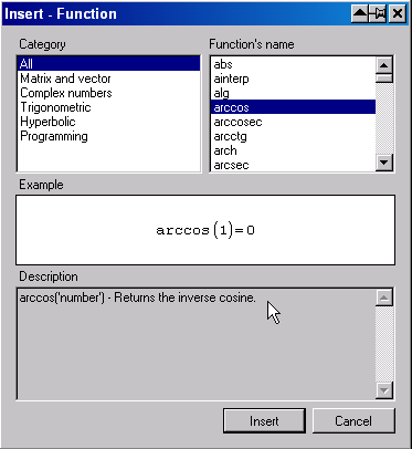

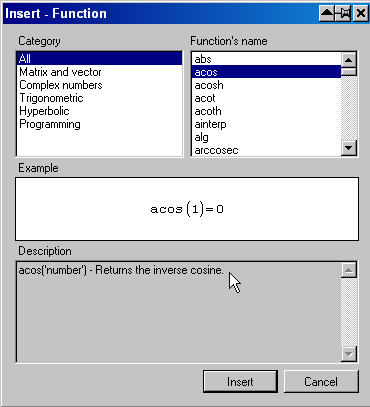

The names of the built in functions depend on the menu option Tools=>Options and the Interface tab. There are two options under Functions style : World and Europe. For instance, function for the inverse cosine is acos in the World style and arccos in the Europe style:
World
World
Europe
Europe
NOTE: The saved files will be opened and the function names will be used according to the chosen style. It is not possible to change the style in the active file - the error (unknown function) will occur.
