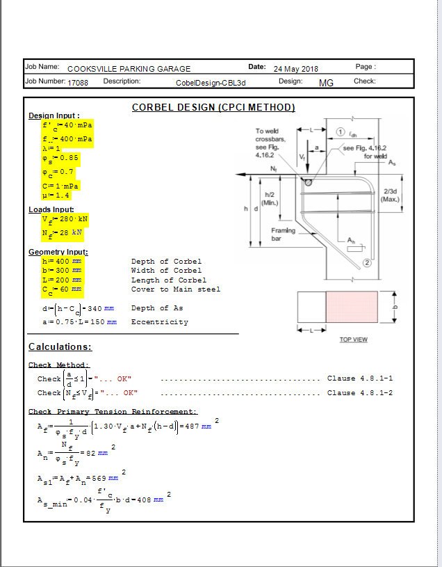

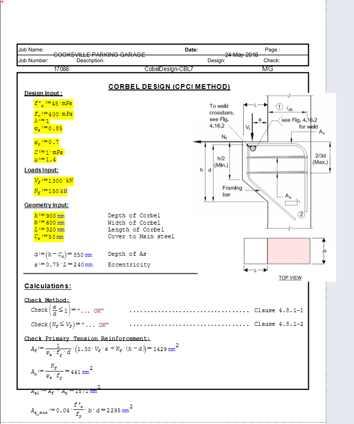

Hi, for some reason after I installed the new version when I open previous files the content does not fit anymore within the page.
I tried uninstall SMath and reinstall older versions but still have the same issue.
Can anyone help? this will be lots of work to re-fit everything back within the page.
The first figure is for the messed format, the second one is for the original format.
Thanks.

If I recall, this latest update fixed some issues with regards to display scaling, which is probably what has caused your format issues by updating. Unfortunately, I believe your options are to either stay with the the older version, or refit everything manually.
