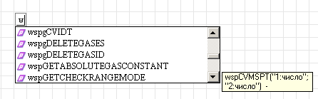

uni, I'm talking about errors when trying to use the dll from http://www.wsp.ru/ru/download.asp with your plugin... Please, could you support it? I've checked the code, but don't know how to fix it - the error appears in the file https://smath.info/svn/public/plugins/mcadefi/mcaduser/EFIManager.cpp in the line "throw gcnew Exception( "Error in mathcad efi function: "". If you have no time for this, could you please advise how to fix it? Please! Your plugin is great!

Unfortunately no. Mathcad EFI never supported units. I made a maximum that is possible. I do not recommend to use this interface since it became outdated. As far as I know in new versions of Mathcad PTC forgot about it. There can be you mean something another.
Yes, I tried WaterSteamPro, there are too much functions. I had no license to work with them closely. Functions loaded, but no more than that.

No, it was long ago, as I remember in case of function invocation there was a window with the message that there is no license. And the description on the picture is created by a plugin automatically. If we want to make a complete description is required an additional information which isn't available in wspmcad.dll (about units I mean).

Yes, it read additional XML files with the description of functions (but I'm not sure, since didn't work with units). If you look at the function description in the MCADINCL.H file, will see that there is nothing about units.
