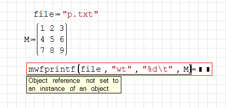

Hi Uni,
For some reason, I always have the same error, using mwfprintf() function.
It looks the same on both 32-bit and 64-bit Windows.
Could you explain what is wrong here ?
#43 Posted: 2/27/2014 5:45:27 PM
1,558 likes in 1,868 posts.
Hi Igor.
There is a log.txt in the plugin directory: \extensions\plugins\4c2faab1-4d93-4904-8d88-a4e21512d179\1.0.4987.26944\
If you look at the contents, you will see errors when working with functions.
In this case, we see a problem in converting the operation result. Probably something has changed in the SMath Studio and my examples stopped working correctly.
mwfprint() works fine, but you need to set the current folder or absolute path. The error occurs after running the function while trying to return the result of work in bytes.
I will try to fix the error, if I can. Now I don't have the latest source.

Hi Uni,
Updated. Try now (with SMathStudio_Desktop_0.97.5189_32bit.exe for 64-bit).

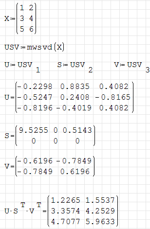

#52 Posted: 7/27/2014 7:17:40 AM
Updated. svd() added, but I'm not shure about how it works (correctly or not).
#53 Posted: 7/27/2014 8:38:32 AM
I think something is wrong here. U matrix has extra column and S matrix should bi diagonal.

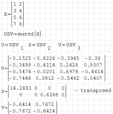

#54 Posted: 7/27/2014 8:55:26 AM
Matlab svd example. S - transposed (I don't know why).
#55 Posted: 7/27/2014 9:15:38 AM
Updated. svd() fixed.
Radovan Omorjan 7/27/2014 9:26:00 AM
#56 Posted: 7/27/2014 9:28:48 AM
I see. Thank you uni. I thought on [U,S,V] = svd(X,0) only.

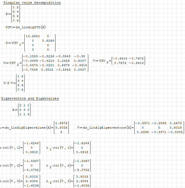

#58 Posted: 7/30/2014 6:51:59 AM
By the way, there is Dot Numerics plugin - by uni
