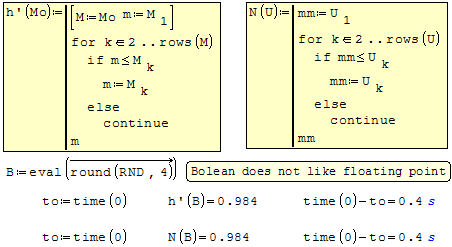

The only thing that remotely comes to mind is that M, being defined within the program structure as M:=Mo, is not having to read for the variable from the outside.
Have you, or anyone else, tried this on other programs?
What's wrong or incorrect in there is length it shouldn't exist in Smath
Hi Jean. Of course that it exists: length(M):=rows(M)*cols(M).
The matrix is square 75x75. In your image you only execute the function for the first 75 values of M and not the 75x75 = 5625 values.
The program also makes use of SMath's ability to access the elements of a two dimensional array by means of a single index because it is more compact, since it requires only one loop.
For small matrices it seems that there are not difference between "the M=M" version and the other. It's just for big ones, whatever big means.

Nearly every function I use with a matrix M as argument starts with |M#:=M
A long time ago I stopped wondering why that's such a immense advantage in speed and just accepted it like it is.

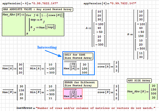

#32 Posted: 8/22/2021 10:28:04 AM
NDTM Amarasekera
NDTM Amarasekera
130 likes in 352 posts.
Vectorize function on Nested Array revisited.
Cheers!
