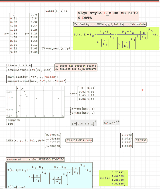

The problem in the calculation of the second LM algorithm in SS6179
occurs in the calculation of the Jacobian matrix for finite differences,
since in this step, after several iterations, for over unknown reasons an
overflow error occurs (possibly a calculation engine error ).
I have slightly modified the LMSA function and I have been able to solve the
problem indicated with 4 data. The solution that uses all the data is not possible in SS6179.
Solved LM SS 6179.sm (147.18 KiB) downloaded 1319 time(s).
I hope you feel comfortable with this.
