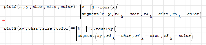

BTW, I would suggest to use another version of plotG which is much faster then previous one (and simplier):
plotG(x,y,char,size,color):line(k:range(1,rows(x)),augment(x,y,el(r3,k):char,el(r4,k):size,el(r5,k):color),2,1)
plotG(xy,char,size,color):line(k:range(1,rows(xy)),augment(xy,el(r3,k):char,el(r4,k):size,el(r5,k):color),2,1)
Davide Carpi 2/16/2018 8:54:00 PM

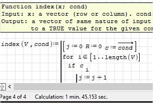

Hi. Just one more thing, I guess: the only one remaining matlab function, mwfind replaced. (Orignal work have many) If I'm not wrong, it is now 100% SMath native. But double the amazing time obtained by Davide. But it's just a "scalar" implementation, sure there are better ones.
PD: I don't replace plotG because don't understand very well that syntax.
InterX.r1 - ranged indices.sm (90.75 KiB) downloaded 1209 time(s).
#32 Posted: 2/16/2018 4:45:48 PM
2,343 likes in 4,057 posts.
It is simple - ranged indexes used.
Just take a look at the speed:

But actually the plotG(4) routine was which confuse me. I prefer
plotG(xy,char,size,color):if(cols(xy)>1,plotG(col(xy,1),col(xy,2),char,size,color),plotG(Re(xy),Im(xy),char,size,color))
because I think that any good plot implementation must to use complexes but not couple of reals. So, if xy argument have only one column, one can assume that data are as Z = X + iY.

Andrey misses this detail of your function about the complex values, but you can still do it; keep the if statement and replace the loops (the case with more than a column as shown by Andrey doesn't require the col() functions, this is redundant and time consuming... If you think that more than 2 columns might be provided, add the case and a single sumbatrix instead )
Here's my pure SMATH find function. with similar time to MWFIND.
InterX.r1 - ranged indices_alyles.sm (94.58 KiB) downloaded 1245 time(s).

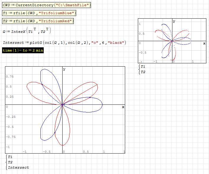

Hello Marco,
I'm trying for the intersection of the two Trifolium, .
blue => native ... red => rotated.
They are created in "Page1 Trifolium.sm
Then recalled for the InterX(T1,T2)
Nothing happens >>> 1 hr ? [Win 7 Starter Edition ... 1.66 GHz]
Is it supposed to work ? Thanks in advance.
Page1 Trifolium.sm (32.5 KiB) downloaded 1492 time(s).
Maths InterseX [Marco].sm (51.7 KiB) downloaded 1019 time(s).

Hi Jean.
You are using an old version of the program. Try this one.
Notice that the point (0,0) is found several times by the algorithm. It could be interesting to check if it get the correct number of crosses at the origin.
InterX.r1 - ranged indices_alyles.sm (88.24 KiB) downloaded 1201 time(s).
