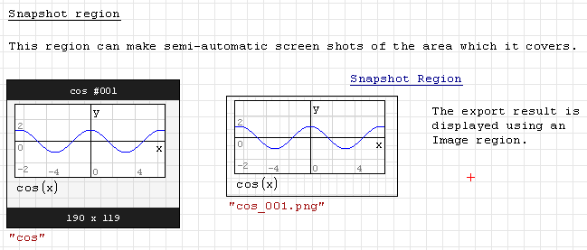

WroteHandbook page for Snapshot region added.

WroteI'd propose to write the export files with white background instead of translucent. Perhaps this might be an option. The problem shown in the attached image could also be solved by the image region providing white background. But that would not be entirely equivalent, because the Image region is currently unaware of the image dimensions.
That's an image region feature, the exported PNGs are not transparents (try yourself opening the images with an image editor)

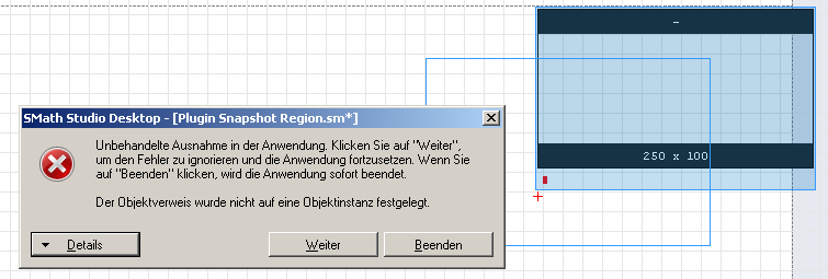

anstelle dieses Dialogfelds finden Sie am Ende dieser Meldung.
************** Ausnahmetext **************
System.OutOfMemoryException: Nicht genügend Arbeitsspeicher.
bei System.Drawing.Bitmap.Clone(RectangleF rect, PixelFormat format)
bei SnapshotRegion.Implementer.ExportSnapshots(MenuButtonArgs args, ExportSet flag)
bei ..(Object , RegionBase , MenuButton )
bei ...(Object , EventArgs )
bei System.Windows.Forms.MenuItem.OnClick(EventArgs e)
bei System.Windows.Forms.Command.Invoke()
bei System.Windows.Forms.Control.WmCommand(Message& m)
bei System.Windows.Forms.Control.WndProc(Message& m)
bei System.Windows.Forms.Control.ControlNativeWindow.WndProc(Message& m)
bei System.Windows.Forms.NativeWindow.Callback(IntPtr hWnd, Int32 msg, IntPtr wparam, IntPtr lparam)
