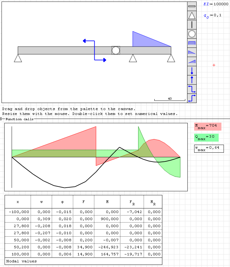

One more update:
- up and down forces
- left and right moments
- table of nodal results (including support reactions)
- sign of shear and moment line changed (positive direction for shear and moment is upwards in the diagram)
The stuff is uploaded as example. It can be opened in the cloud version, you won't see, however, the table of nodal results because it uses the table region plugin by Davide.

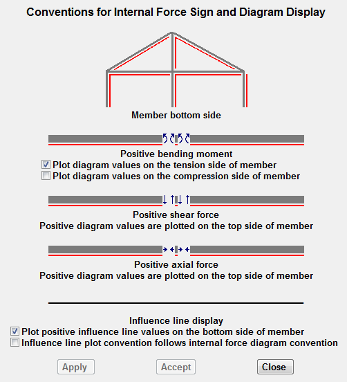

There'a an easy way to setup the diagrams conventions? Usually I use the shear as in your last example and the positive moments on the tension side...
i.e. the Signs conventions panel of Ftool
Martin Kraska 10/5/2014 2:14:00 PM
#49 Posted: 10/5/2014 2:10:44 PM
1,362 likes in 2,276 posts.
Setting the signs is easy. Have a look at the function BeamPost().
The convention used in the final example is that which I use for teaching.
External forces correspond to steps in shear and distributed loads change the shear curve in the direction they are sketched.
The shear line gives the slope of the moment line. This facilitates easy sketching of the lines without non-obvious sign conventions.
the drawback is that the positive direction in M and Q diagrams is opposite to the positive direction for external loads and displacement.

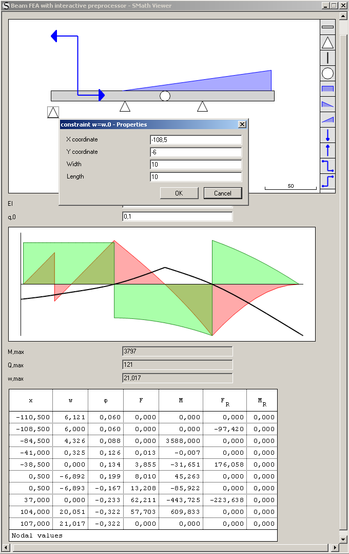

- Non-zero displacement constraints (y position of triangles is evaluated)
- Solver crashes due to non-invertible systems avoided by connecting orphan nodes with low
stiffness beams
- Instructions added
The code should be fairly stable now (impossible to crash by whatever senseless model layout). Please report any issue.
sergio 10/6/2014 3:46:00 AM
#51 Posted: 10/6/2014 5:43:06 AM
Don't ask me why, but now BeamFEA.sm runs in the viewer.
I uploaded it as application to the gallery (table of nodal values is missing, because the exe is compiled on server side without external plugins.
If you want an executable with table, then save the example as exe and you are done.
