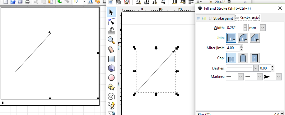

I am not sure if this counts as major grief, but here is screenshot where displayed stroke style is different from what was intended in inksape.
____________________ certainly very annoying:
... missing closure in Inkscape ? ... problem saving from Inkscape ?
... Smath not reading correct ? [doubtful]
Read more: once the object is imported in the image region,
"Reset to original size" ... stretch the right handle to create space.
At this point, if you want to zomm ± : move the bottom handle up/down,
that procedure will respect the "Aspect ratio". I have checked the Smath
image zoom with IrfanView: for photos they are ~ equal quality.

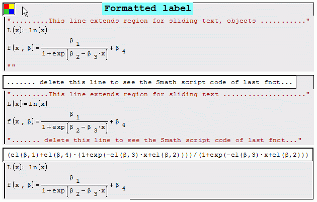

The last brick in the wall about editable region(s) is the "Formatted Label".
Possibly useful for collecting functions of same family, vg: PDF, CDF ...

This release addresses all the issues below.
Not resolved:
1. Rendering of inkscape arrows. Even though I am using new SVG renderer, the arrow is still off - now it is reversed. On a plus side - arrow on the left end of line points correctly - use that one.
