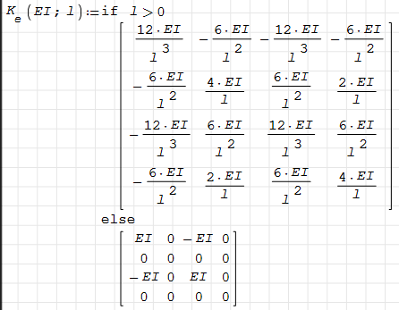

In the 1D beam analysis application BeamFEA, I use hinge elements for rotary dof release (to insert a hinge in the beam). They connect coincident nodes of adjacent beam elements.
In the 1D case, the element matrix is just parametrized by the stiffness EI and the length l. The dofs are w1, phi1, w2, phi2. A hinge element is generated if l=0. Then the EI value is taken als spring stiffness between the w dofs of the nodes. This means that equal w for both nodes is not enforced by reduction of the system but by a penalty term.
![2022-04-21 09_52_31-SMath Solver - [BeamFEA.sm_].png](/en-US/files/Download/yv8ATM/2022-04-21-09_52_31-SMath-Solver---[BeamFEA.sm_].png)

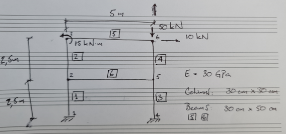

WroteI verified the results in the attached file with some 2D structural analysis software and it appears to be correct correct. Take a look and let me know.
I made some mistakes creating the stiffness matrices for rigid-hinged and hinged-rigid. In my post I edited the image. What was wrong? Well, as it was new to me this stiffness factor of 6 for the rotation around the hinge, I tested and found that it was non-sense, because the adjacent member rotating would not introduce displacements in the hinged element. (Further considerations like friction (end-moment) transmitted through the hinge could be studied, if relevant).
For now I have made tests with this simple model of 6 members. Beam 6 was tested for rigid-rigid, rigid-hinged, hinged-rigid, and hinged-hinged conditions. Comparing with FTOOL (recommended! very simple and useful tool) I all those 4 cases, I've found the same results for the x, y displacements and z rotations with 4 significant digits each (probably more but didn't look at).
Please comment if you test more complex models and loads.

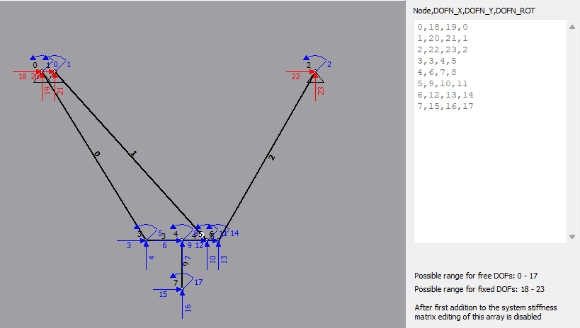

So what I am trying to do is replicate the frame analysis by FEM, but for this specific case and then be able to apply a load at 360-degrees in order to find the worst case for each "strut".
This can be done without FEM, with just trig and statics, but only up to a certain number of unknowns. So hence the FEM method.
Thanks for taking a look. I think we should be able to accommodate a hinged-hinged case through the means of a (pinned support)-fixed end--hinged end.
I'm using a program called LinPro 2.7.5, it is a free static and dynamic frame analysis program. https://www.thestructuralengineer.info/software/linpro-275
It handles this case quite well.
It allows you to implement a Study Mode, which shows you the step by step process the program is taking to solve the system.
A couple of notes regarding the program as apposed to what I've seen in other places:
-The modified local stiffness matrix for various member end release conditions seems to be different from what I found in my text book (Matrix Methods for Advanced Structural Analysis - Papadrakakis & Sapountzakis)
For example: Where you might expect to have 3EI/L^3, it seems to have 36EI/L^3, so I'm not sure what exactly they are doing to obtain the modified local stiffness matrix
-The program also always restricts the "fixed" constraints to the end of the DOF numbering.

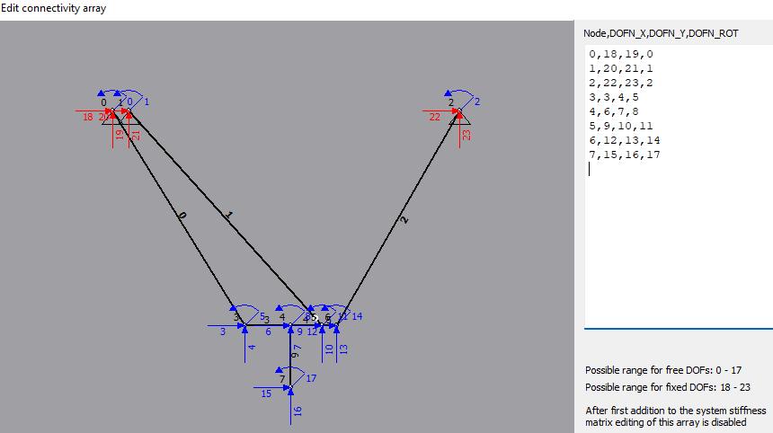

For the sake of simplicity, I eliminated some of the automated vector assemblies, as I didn't want to spend too much time trying to figure a good way to work with the DOFs as they are shown in LinPro.
Assembly Vector - Manual
Elimination Vector - Manual
Force Vector (global) - Manual
They start with 0, SMath with 1, so keep that in mind.
What they do is restrict the fixed DOFs to the end of the DOF numbering.
Now, my K (global) matches the result from LinPro exactly.
There was some interesting things that had to be done to make that happen:
As Jean has pointed out in the past, the order of matrix multiplication has varied results.
It seems that for this configuration:
![2023-03-08 17_23_58-SMath Solver 1.0.8348 - [New Frame FEM Example.sm_].png](/en-US/files/Download/nhTBqC/2023-03-08-17_23_58-SMath-Solver-1.0.8348---[New-Frame-FEM-Example.sm_].png)
I could not get the global k matrix to match the results in LinPro.
I ended up arranging it like this:
![2023-03-08 17_24_09-SMath Solver 1.0.8348 - [New Frame FEM Example - Updated.sm_].png](/en-US/files/Download/zy4hgV/2023-03-08-17_24_09-SMath-Solver-1.0.8348---[New-Frame-FEM-Example---Updated.sm_].png)
And it worked.
I also removed all units for now, because as it seems, the inverse operation of a matrix requires numeric evaluation, and with units, I get a "units don't match" error, and you can't evaluate the inverse symbolically for some reason (That's a whole different topic for another day...).
In any case, After getting the right complete stiffness matrix K, it seems that things go south. Solving for the reduced displacements vector is way off.
It seems that LinPro produces an updated forces vector after solving "the system of equations" that includes the reactions at the fixed DOFs along with the forces applied.
It makes me wonder if perhaps there is something off in the sequence we have in the SMath sheet.
After we assemble the complete stiffness matrix K, we obtain a reduced K, Kr that eliminates the fixed DOF (in this case, the last 6 DOF, 19-24).
Then we use that Kr along with a reduced F, Fr, to solve for reduced deflections, Qr.
Is all this right?
Maybe a set fresh of eyes can find the problem here:
New Frame FEM Example - Updated.sm (129.74 KiB) downloaded 1366 time(s).
