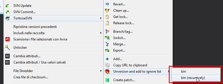

In the release manager I get an error, here is the log for the updated .csproj file in SVN
I've updated the ImageEditRegion folder in the SVN:
- removed bin and obj folders (you can add these windows folders to the ignore list, so you can avoid to commit them unintentionally);
Show Spoiler
- fixed the *.csproj header: ToolsVersion "10.0" -> "4.0";
- RequestForEvaluation() updated to RequestEvaluation();
- removed references to the SS executable not driven by $(SMathDir);
- removed *.suo file, updated the project GUID in *.csproj, *.sln (not sure it is relevant, however seems more consistent);
I can run it successfully in Visual Studio 2015, SharpDevelop and the RelaseManager

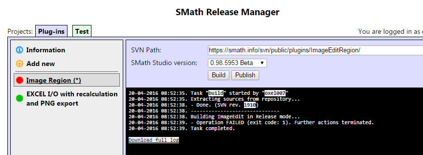

Davide, the tweaks you made still do not allow me to build the plugin using
http://smath.info/ReleaseManager/
(same errors as in previous log)
Are you saying it works for you? Is it something to contact Andrey about?
Of course I can switch back to using old .dll's but it is not the right way going forward... Also how do I use Entry instead of Term? Will it make working with RGBA matrix faster?
Thanks

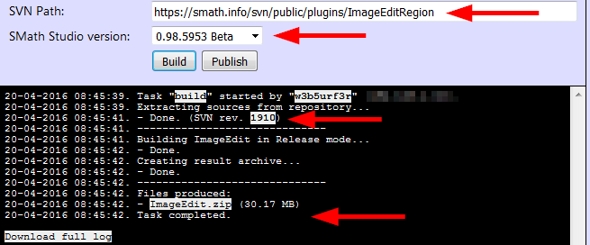

#57 Posted: 4/20/2016 12:49:06 PM
I confirm it works for me... which is the target version you are using?
#58 Posted: 4/20/2016 12:56:00 PM
Alexander O. Melnik
Alexander O. Melnik
127 likes in 498 posts.
Fails for me
report.log.txt (38.5 KiB) downloaded 1451 time(s).
Time to contact Andrey.
Also what is you comment on this?
Quote
Thanks!
#59 Posted: 4/20/2016 1:08:25 PM
Fails for me
I think you are right...
warning MSB3245: Could not resolve this reference. Could not locate the assembly "SMath.Controls". Check to make sure the assembly exists on disk. If this reference is required by your code, you may get compilation errors. [{SourcesDir}\ImageEdit.csproj]
Since I don't know how it works the RM, I can only suppose that there is some sort of "cache effect" for your account because previously you have compiled the plugin with the old APIs (?)...
It may worth the effort, since images are made of a lot of data (you have to change just one thing - but actually I have no idea how to convert base.Terms to an Entry); just to mention, if you use it, the updates for SS versions < 0.98 are a little bit more difficult to provide (since you have to change the code).
#60 Posted: 4/20/2016 6:12:42 PM
2,343 likes in 4,056 posts.
Error discovered in Release Manager. It is fixed now.
Please try to build plug-in again.
Best regards!
