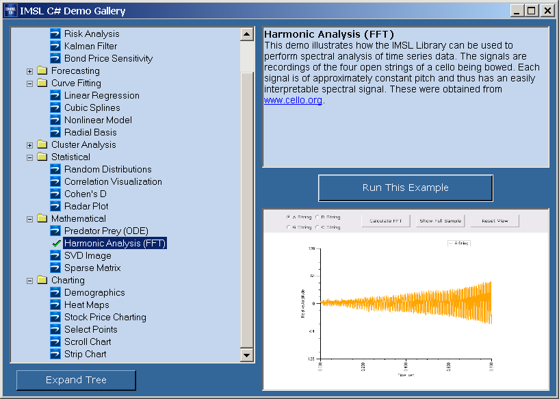

#54 Опубликовано: 21.06.2013 09:30:55
There are well-known IMSL® Numerical Libraries. Many people use this library, but it is commercial. This library exists in different versions (c# one of them). It can be used to extend SMath Studio.
