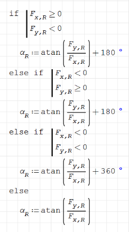

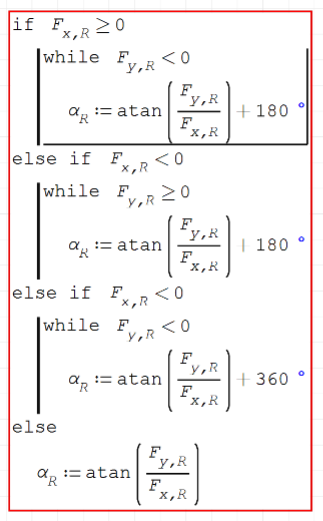

I think there is a very strong confusion, since the original user of the doubt,
published in his third answer the following:
Since i don't understand how i can ad my SMath Solver I try to explain it more.
I have a Task. The first stepps are allready done.
My last step is:
Lets say i have
X:10
and Y:6.
I got a Formular to solve a angle:
a°=atan(x/y)
BUT if x or y is Negative my formular is:
a°=atan(x/y)+180°
and if x and y is negative my formular is:
a°=atan(x/y)+360°
In conclusion my problem is i don't understand how to say
as soon as 1 of these conditions are suffused --> solve the formular for a° and end the loop.
Like
IF X & Y is positive solve:
a°=atan(x/y)
IF X is positive and Y is negative solve:
a°=atan(x/y)+180°
IF X is negative and Y is positive solve:
a°=atan(x/y)+180°
IF X & Y is negative solve:
a°=atan(x/y)+360°
I hope you underdstand me and can help me.
Sorry for my bad english
thanks in advance
I tried your advice with 2 IF in once but i don't undersand how to "end/close" the loop.
As indicated in the published, it is requesting the calculation of "aº = atan(x/y)",
which corresponds to the calculation of the angle next to the Opposite Leg
a°=atan(x/y)
a°=atan(x/y)+180°
a°=atan(x/y)+180°
a°=atan(x/y)+360°
#24 Опубликовано: 15.06.2023 10:02:58
1 098 сообщений из 1 770 понравились пользователям.
Owner of post asked for y/x, not x/y.
a°=atan(x/y)
a°=atan(x/y)+180°
a°=atan(x/y)+180°
a°=atan(x/y)+360°
That's form the post #3.

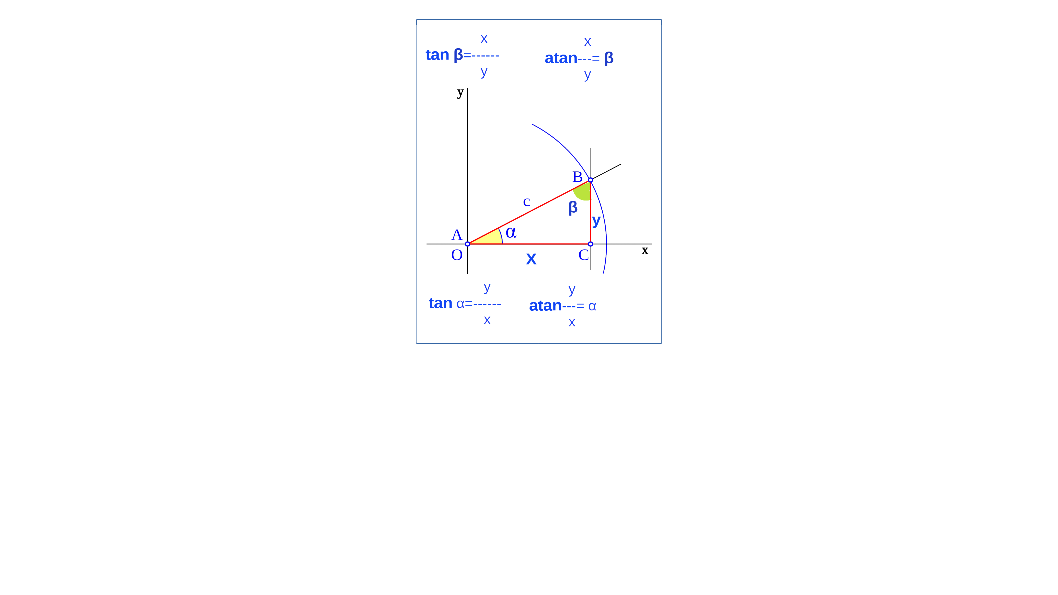

From the first post:
From the big picture in the post #6:
And form the physical context, where is trying to decompose a plane Force into its horizontal and vertical components, it's obvious that those are the correct formulas, and not the ones "handwrites" in the post #3. For this is because one choose a wysiwyg live math editor like SMath and not a death plane text like octave for make engineering calculations.
which corresponds t▪o the calculation of the angle next to the Opposite Leg
That ends this atan(▪,▪) pugila
Sostenella y no enmendalla!
Perfect. As my last post in this topic, I can conclude that this angle is atan(4,2) = 63.4349° in your world, but it is atan(2,4) = 26.5651° in mine; that the formulas that are written in SMath are irrelevant, as are any evidence that that angle is not the one you say. Where was that "The correct value is Smath code for Smath projects."? Forget it, I really don't care. I just wanted to prevent you from being able to fool others, but I admit that you are very good at it. You win.
#27 Опубликовано: 15.06.2023 17:17:56
Your conclusion is correct.
The demand was atan(x/y)
Your interpretation is atan(y/x) ... End of it.

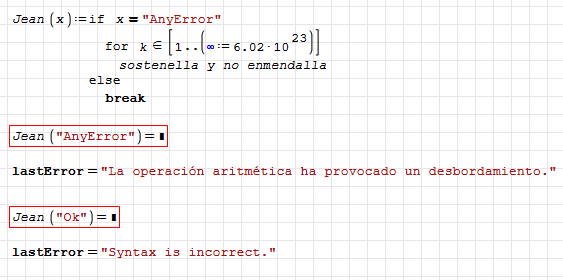

While walking in the forest,
if you come across twice the same tree, you are lost !

He has given sample from Carlos. Look what he posted, elementary school information for atan() calculation.
What is the angle calculation for a°, well it is obvious. atan(y/x) or atan(y,x).
Let me count: One
... two ...
Oh! I see the same tree indicating atan(y/x) twice in the forest! At least I know now why you feel lost.
Again. You win: I have no way to stop you from trolling people. I can't stop you saying that this angle is 63.4349° and not 26.5651°.
