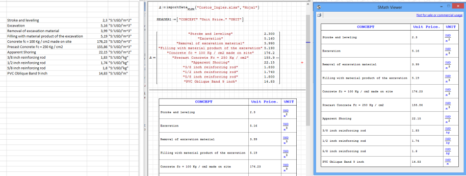

I found a way!
But it takes time depending on how many vectors you use.
I defined the single element indexes and gave them a name.
Hello G-Tate
I think it is better that you use Excel for data in the form of Vector or Matrix,
and then import them from SMathStudio, so that, the changes you make are saved in the Excel sheet
PruebaImport_Cost_English.zip (1,01 МиБ) скачан 672 раз(а).

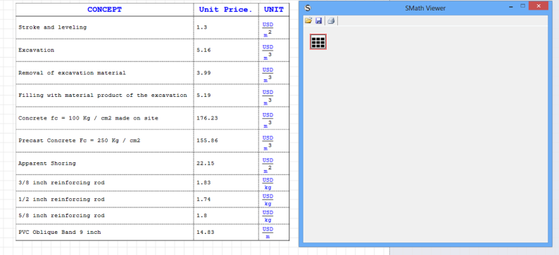

#22 Опубликовано: 13.06.2019 13:40:29
Oscar Campo
Oscar Campo
Ok...but...
I think that the point is that in this way you neither can edit any value in the viewer...

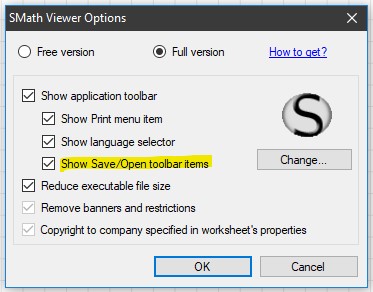

#27 Опубликовано: 29.05.2021 08:37:19
2 343 сообщений из 4 056 понравились пользователям.
Группа: Super Administrator
It is now possible to Save input data using Save dialog. It is also possible to load saved data using Open toolbar item afterwards - all saved values will be restored.
To enable Save/Open functionality an appropriate checkbox must be set to true during Save to *.exe:

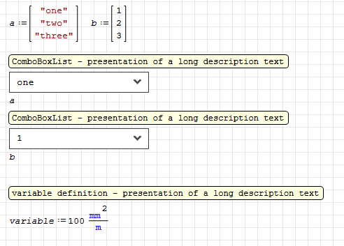

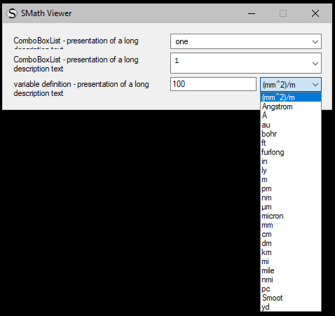

This is my first post here. I have been using SMath for several years, and also SMath Viewer for some time. I created a few simple programs to facilitate frequently performed activities. I'm a huge fan of the entire SMath suite. While working with SMath Viewer, I found a few small things that I think could be improved.
The first one probably does not relate to the SMath Viewer itself, but the ComboBoxList extension. The longer description of the list does not fit into the window, making it unreadable (as shown below). This happens when the list contains text elements. Working with numbers does not cause this problem.
The second problem relates to units. When a variable (or result) is in a non-standard unit (as shown below), the program gives the user a choice from the list to units that do not match the number completely. Incompatible units should not be proposed. It would be nice to be able to select the unit set when creating the EXE file. For example, I don't need imperial units in an EXE file.
#29 Опубликовано: 24.09.2022 10:49:18
Thank you for reporting the issue. It wasn't easy to find the cause but should be fixed now, I've released an updated plugin for the latest stable version of SMath Studio.

Damian
Damian
Thank you very much for this update. Now it works like a dream
