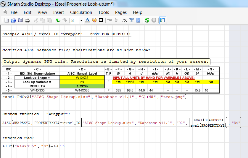

Alexander O. Melnik
Alexander O. Melnik
Not sure if I am grasping the root of the issue, but you can fairly easily write a wrapper as a smath user defined function using excel_IO. One would think that this way you can write a wrapper for any custom .dll for EXCEL.
All I have done was creating a simple Index(Array,Match(),Match()) lookup in EXCEL (with proper implementation of SMath units), and used excel_IO to work with it.
Seems to work very fast.
As always - please test for bugs and use at your own risk.
P.S.: Update excel plugin for proper handling of cell error values
AISC Shape Lookup.xlsx (3,27 МиБ) скачан 1930 раз(а).
Steel Properties Look-up.sm (20,36 КиБ) скачан 1441 раз(а).

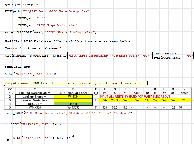

First of all I would not want to take credit for something I have not done - it was RFeund who created the majority of the SMath workbook you were looking at. I just helped him to make it work as he intended. So I will leave it up to him to incorporate first of your two very relevant comments.
Small note though - the latest version of the plugin (0.2.0.28218) should import values with units from excel. Those units can be converted to inches as per usual SMath operation:

I have taken to:
-explicitly defined the directory and file that within SMath
-force Excel to be visible.
This is what I have been putting in my worksheet to be explicit for definitions. I am still trying to work through Davide's example.

In the image bellow it is reproduced the situation when the plugin cannot open a Excel file that is already opened
Wishes of a Happy New Year to you too!
I think I can try to bypass this issue, at least while reading. Stay tuned.
