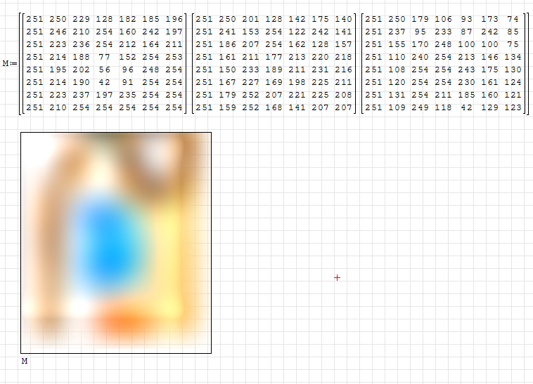

Alex, can you see this matrix in the image region?
mat(mat(251,250,229,128,182,185,196,251,246,210,254,160,242,197,251,223,236,254,212,164,211,251,214,188,77,152,254,253,251,195,202,56,96,248,254,251,214,190,42,91,254,254,251,223,237,197,235,254,254,251,210,254,254,254,254,254,8,7),mat(251,250,201,128,142,175,140,251,241,153,254,122,242,141,251,186,207,254,162,128,157,251,161,211,177,213,220,218,251,150,233,189,211,231,216,251,167,227,169,198,225,211,251,179,252,207,221,225,208,251,159,252,168,141,207,207,8,7),mat(251,250,179,106,93,173,74,251,237,95,233,87,242,85,251,155,170,248,100,100,75,251,110,240,254,213,146,134,251,108,254,254,243,175,130,251,120,254,254,230,161,124,251,131,254,211,185,160,121,251,109,249,118,42,129,123,8,7),1,3)
Hope its not one of those hard to trace bugs that are hardware / OS dependent
M.render.sm (8,55 КиБ) скачан 1507 раз(а).
#73 Опубликовано: 16.05.2016 15:29:20
Thank you! Solved, seems I was having a newer version installed (?)
Uninstalled and downloaded again, now it works :d

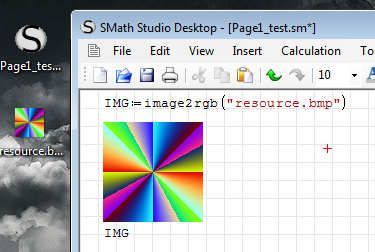

Using latest Nightly Build of SMath Studio and the last beta of Custom Functions.
Alex, can you make the double-click feature enabled just on the canvas of the region? It is really annoying while trying to edit the math content
Could you please provide an example? I have just opened my balloon test file and nothing happens if I double click anywhere on the region.. as it should be.
Not sure what happened... while editing the file for posting the screenshots the default viewer was launched several times, now I'm no more able to reproduce. Don't worry, if it will happens again I'll try to find the way to reproduce it.

Hello, Alex.
I've also reproduced it today but cannot say what exactly caused this. I've used many double-clicks on R, G and B variables inside the region and pressed Ctrl+C/V several times... First impression was that pressed Ctrl button broke the logic somehow.

Found it! Seems related to the exceptions
1. Add a region in the canvas;
2. add in the placeholder something like mat(identity(3),identity(3),identity(3),1,3);
3. change one of the RGB channels with a number (e.g. 1) -> mat(identity(3),1,identity(3),1,3);
4. double-click will launch the image viewer;
BTW, you should propagate the evaluation exceptions to the user, currently you can't notice when something fails in the evaluation...
