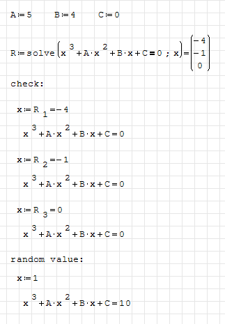

Hi
Could you help me with this? I tried to solve this cubic equation
A=solve(x^3+A*x^2+B*x+C=0,x)
where A=5, B=4, C=0, the answer give me only two roots 5 and 0, instead of three. The right answer is -1, 0, 5.
Could you explain me what can I do or what is wrong?
Thanks
#30 Опубликовано: 16.04.2015 11:44:55
No issues here

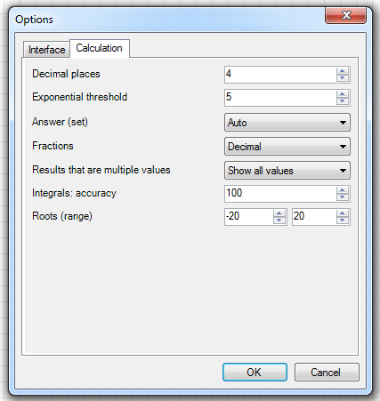

I see... BTW also the cloud version gives 3 roots
Yuo can try to check if something is different in the global settings (Tools > Options... > Calculation)

#33 Опубликовано: 16.04.2015 20:09:42
robinson
robinson
Now is working. I changed Roots (range).

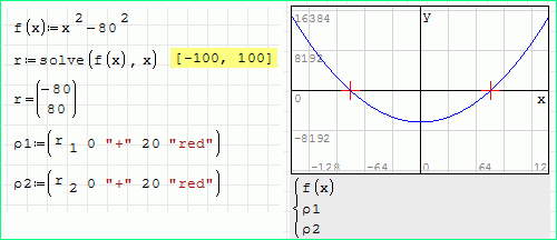

#35 Опубликовано: 13.08.2015 00:06:32
Here are your two plots c/w the roots shown on graph.
I have used the 'Solve Quick' in separate sheets not
to confuse solve[f(x),x] with the two differents
search range. Handling graphs are very easy, just a
matter of adjusting each direction [X,Y] separately.
Your solve with bracketed search range is perfect too !

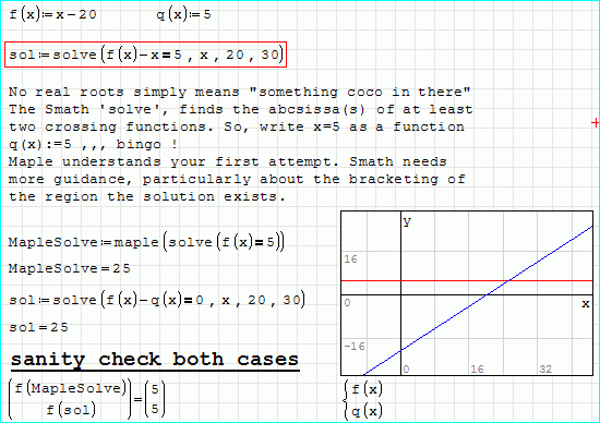

#39 Опубликовано: 20.08.2015 23:28:50
Collab,
Your turmoil is solved. Always plot before you attempt more maths.
