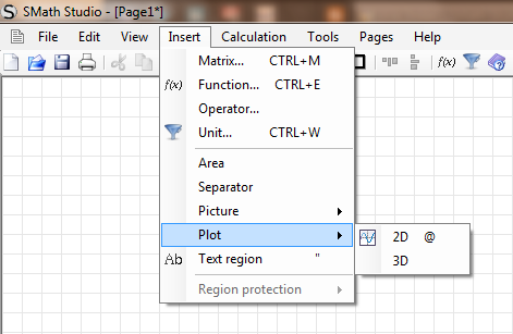

How to add an empty graph
You can add a 2D/3D Graph from the
Insert item in the menu bar:
Insert > Plot > 2D / 3D
Keyboard shortcut: a 2D Graph can be added directly typing @
Now an empty graph will be added:
