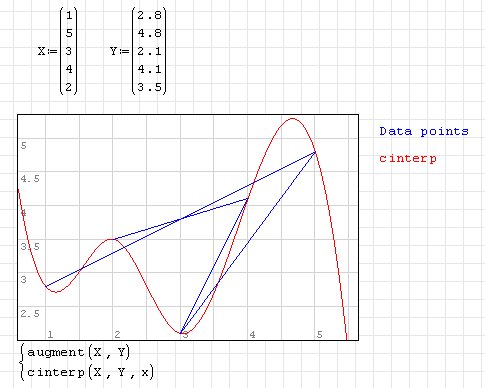

X-vector not sorted . As the main usage of the interpolation is to estimate y-value for the x-value not given in the table, this is
not advisable:
