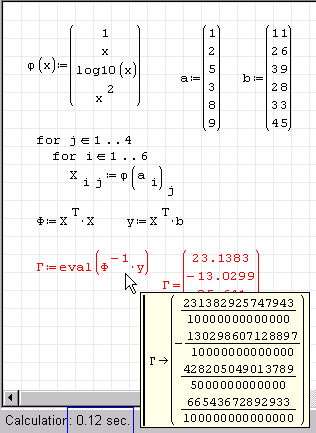

See the example which uses eval (see the calculation time).
eval1
If you point the particular expression, you will also see the result of symbolic calculation (in the form of tooltip). Compare the symbolic (tooltip) and numeric notation (obtained with "=")

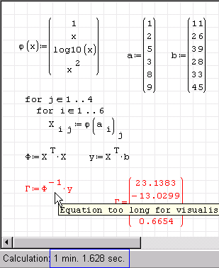

Now, compare the calculation time for the same example without eval. Moreover, pointing on the expression will give the tooltip that the expression is to large to be visualised.
eval2

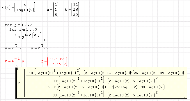

Finally, to clarify this we will simplify the above calculation and we could see how the symbolic calculation could be very comlicated.
eval3
