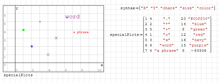

Special plots (words, points, colors...)
You can plot words or characters (strings) on your graphs;
- Special characters (case sensitive) have position fixed on center on the given coordinates: + . * o x;
- Words, phrases or non-special characters have top-left corner of (virtual) textbox fixed on the given coordinates;

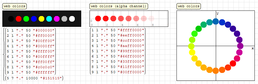

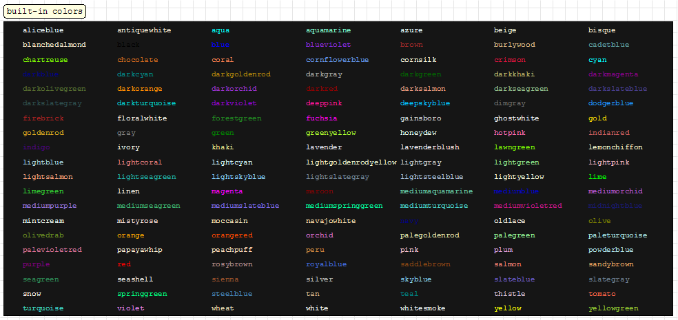

- Many colors are allowed, using web format (like #6699CC) or by name; here is a complete list of possible colors (spaces and upper case letters are not matter):
aliceblue, antiquewhite, aqua, aquamarine, azure,
beige, bisque, blanchedalmond, black, blue, blueviolet, brown, burlywood,
cadetblue, chartreuse, chocolate, coral, cornflowerblue, cornsilk, crimson, cyan,
darkblue, darkcyan, darkgoldenrod, darkgray, darkgreen, darkkhaki, darkmagenta, darkolivegreen, darkorange, darkorchid, darkred,
darksalmon, darkseagreen, darkslateblue, darkslategray, darkturquoise, darkviolet, deeppink, deepskyblue, dimgray, dodgerblue,
firebrick, floralwhite, forestgreen, fuchsia,
gainsboro, ghostwhite, gold, goldenrod, gray, green, greenyellow,
honeydew, hotpink,
indianred, indigo, ivory,
khaki,
lavender, lavenderblush, lawngreen, lemonchiffon, lightblue, lightcoral, lightcyan, lightgoldenrodyellow, lightgray, lightgreen,
lightpink, lightsalmon, lightseagreen, lightskyblue, lightslategray, lightsteelblue, lightyellow, lime, limegreen, linen,
magenta, maroon, mediumaquamarine, mediumblue, mediumorchid, mediumpurple, mediumseagreen, mediumslateblue, mediumspringgreen,
mediumturquoise, mediumvioletred, midnightblue, mintcream, mistyrose, moccasin,
navajowhite, navy,
oldlace, olive, olivedrab, orange, orangered, orchid,
palegoldenrod, palegreen, paleturquoise, palevioletred, papayawhip, peachpuff, peru, pink, plum, powderblue, purple,
red, rosybrown, royalblue,
saddlebrown, salmon, sandybrown, seagreen, seashell, sienna, silver, skyblue, slateblue, slategray, snow, springgreen, steelblue,
tan, teal, thistle, tomato, turquoise,
violet,
wheat, white, whitesmoke,
yellow, yellowgreen
NOTE(1): You can use darkblue, DarkBlue, Dark Blue (recommended), DARKBLUE, D a R k B l U e ant etc...
all spaces will be removed and color name will be converted to lower case chars.
NOTE(2): You can use number instead of color name or web-color.
Number composing rule is a bit complex, but it is similar with web-colors: color represented as a hexadecimal number where
- first pair is opacity;
- second pair is a Red Component;
- third pair is a Green Component;
- fourth pair is a Blue Component;
For example FF00FF00 is a full-opacity Green color (FF 00 FF 00).
When you have a hexadecimal number you need to convert it to decimal number to use it in SMath Studio.
There are snippets to make easy this conversion (see References).
Note that because of the maximum 32-bit integer is 2147483647 (0xFFFFFFFF/2) and FF00FF00 = 4278255360 (i.e. greater then the max. integer),
then Green is FF00FF00-0xFFFFFFFF-1=-16711936.

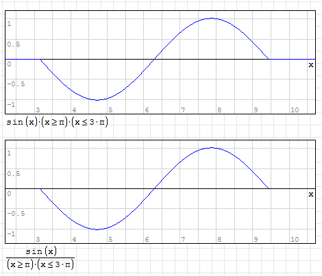

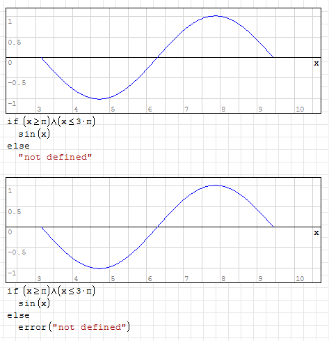

Plot domains
If you want to define a plot inside a specified domain you can follow two ways:
Using an if/else statement
NOTE: Any text (empty or not) or message from the error function will be ignored.
Using booleans as function parameters
NOTE: infinite values will be ignored.

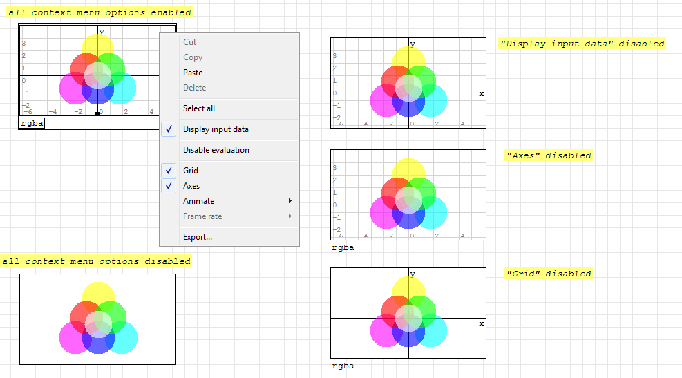

Plot handling
A dedicated plot palette allow some operations on the graph.
- Rotate: rotate 3D graphs (see Known issues).
- Scale: if you roll your mouse wheel it zooms both axes together. If you hold 'control' keyboard key (CTRL) at the same time it just zooms the vertical axis;
if you use the mouse wheel holding the 'shift' keyboard key (↑) it zooms the horizontal axis. - Move: drag the graph up or down, left or right; by default you can move the graph also by clicking and holding the left mouse button on the graph.
- Graph by points: show functions/straight lines as a set of points; could be useful to highlight discontinuities.
- Graph by lines: show functions/straight lines as lines (default).
- Refresh: restore the default view of the graph (axes origin moved to the graph center and zoom with default limits).
Clicking with the right mouse button on the graph appears a context menu that contains other options.
