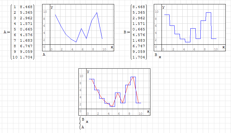

Plot vectors by index
It is possible to plot a single column vector using as index the x variable.
In the plot any x value will be rounded and, if possible, the corresponding vector element will be used as y value:

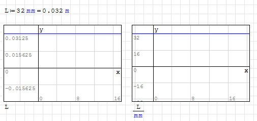

Plot using units
It is possible to use units of measurement inside plots.
Because the output units of calculations are base units (f.e. meters for any length unit), you have to scale the input or adjust the viewport.
