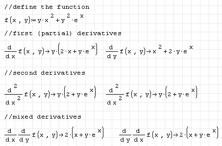

We could have defined the 'expression' f first in variabl x and y, for instance:
deriv1
and found the first derivatives over the variables (partial derivatives, actually):
deriv1
How to obtain the higher order derivatives? Press comma after the 'variable' and in the obtained placeholder insert the 'order' (integer). Here are the second derivatives:
deriv1
Here are mixed derivatives as well: deriv1

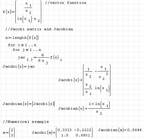

Very important SMath feature is ability to find the derivatives over the elements of a vector (matrix). Here is an example of finding Jacobi matrix and Jacobian:
deriv1
