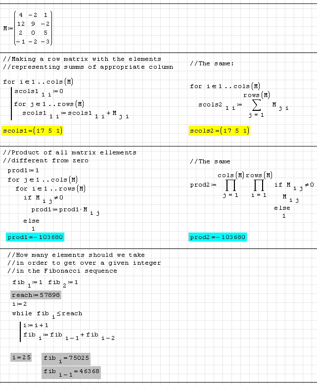

SMath Studio has several programming commands, so you can write procedures.
Besides what is below, there are also Tutorials on programming in SMath Studio: pdf | zip
These are if,for, while and line.

Examples
programming
Take care that some complicated programming structures are not implemented.
