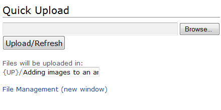

In the Quick Upload section at the bottom of the page, refer to below image, use the
Browse…
button to find the image file on your computer.
Now go to the text box Files will be uploaded in: and type in a folder name that exists, eg floor. This will be the destination folder.
You may need to use the File Management (new window) link to view what folders are available or to create a new one.
Hit the
Upload/Refresh
button just above it.
This loads your image file onto the server in the right folder. You can also go into the folder on the File Management page and upload pictures from there.
