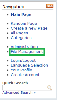

First, from any page of the Wiki, select the Navigation menu's File Management option, shown in this picture:
Once you select that option, you will be presented with a Wiki login page if you aren't already logged in. Logging in requires an account on the Wiki. On the login page, you will be given the option to start an account if you don't have such an account yet.
