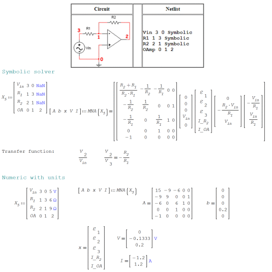

Hi uni. The attached shows that what you need to do that is get inside SMath the net list (and, yes, that's very old school). So, that's means that with some kind of modeler plugin you can get the net list and further process it with some SMath MNA solver, and procedures for bode and others charts.
(example from https://www.swarthmore.edu/NatSci/echeeve1/Ref/mna/MNA6.html#Example%205 )
The MNA implemented can work with opamps, so, given the equivalent circuit for some transistors, you can implement them. What I can't do yet is implement diodes.
Notice that this technique not solve an ode, but get the transfer function.

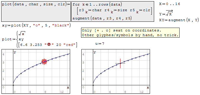

Another trend I adopted recently is to include handwritten sketches in my documents (created with pen and tablet, using Onenote as application). I find myself spending much less time than with whatever graphics software on creating sketches for homework assignments, lecture notes or exams.
For that matter, I help myself further, for projects.
Mathcad 8 sold by > million, delivered with SmartSkech from Intergraph.
The demo c/w applicable maths is impressive. It included ISO circuits symbols,
has not been used except if not published in the Collaboratory.
In 1980, we had graphic packages to draw industrial plant c/w library of symbols.
It would draw from point to point something like Paint, color/thickness as desired.
In the mean time of inventing a new wheel, interested users may advance a profitable pace.
Inst_Filtrate Bin [Level].sm (33.81 KiB)已下载 1431 次。

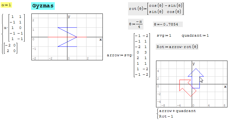

From the 100's documents projects/tutorials I have posted in Samples,
please show at least one where the sun is missing ...
I will show one for decorative, maths/Physics are not decoration.
Spline De Casteljau SVG Companion Drum.sm (51.02 KiB)已下载 1680 次。
Spline De Casteljau SVG Companion.sm (99.13 KiB)已下载 1550 次。

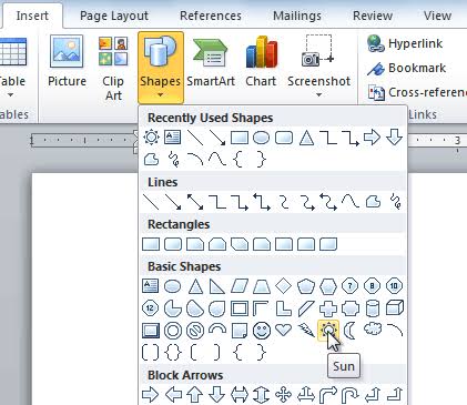

Hi. There are a lot of free resources for include sketch's, diagrams, technical draws and thinks like those in C sharp at sites like github and others. But what I think that is actually missing it's the ability for paste as an object and display it as an image, like the old OLE automation for editable objects like Autodesk draws, Visio schemas and usual windows and linux programs. Those objects are save inside the caller application file and can be easily modified just double clicking on it. Finally, it could be very important if SMath files can be inserted as objects into other windows applications, in other words, SMath as an OLE server.
I would want and regularly use a shape plugin. If it could be implemented well, plugin drastically reduce simple engineering sketch drawing without using any additional software.
I would deeply say YES to OLE implementation too, this is a should be feature actually.
Heck, thinking of OLE capabilities, why it is not in SMath until now?

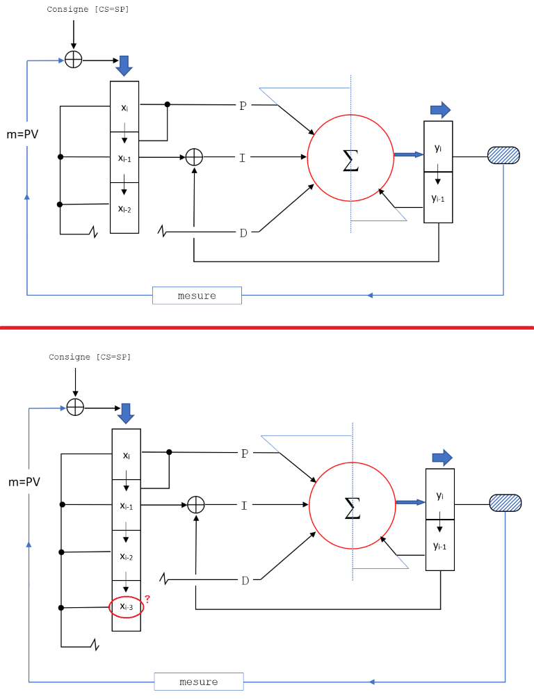

Process Control & Instrumentation is as important than communications.
A Classroom on that is more than years, rather associative life time.
It deserves spending some times to image the math/physics under the hood.
Glyphes gadgets decoration does not bother me.

You really don't understand what we are telling, do you?
What if you really had to change the diagram or create a different diagram from scratch?
In the picture below, I had created your example diagram in MS Word using only shapes. Also added an additional step for you to understand.
It took me for 10 minutes to create it, and adding new step is only 5-10 seconds.
It is scalable and vectorial, you can easily add new items or remove existing without print quality loss.
You can also create it with Inkscape, Adobe Illustrator, etc. But please explain, why shouldn't we also do this inside SMath?
We are just dreaming here (only dreaming at this moment) to create or manipulate this kind of things in SMath Studio.
Because this program is called "Studio". This is not an MatLab or MathCad clone.
You want only calculation, nothing else. If you want only calculation and math why don't you use MatLab at all?
I don't understand your motivation for opposing every new feature or idea, even existing bug corrections.
I remember very well, you had strongly resisted for header/footer also.
In the last weeks we were saying picture importing is not working under Linux and while you are not using Linux at all, you had strongly depicted nothing is wrong with SMath. Blissfully Andrey corrected that bug.
I have started to think you are deliberately doing this.

BTW, such a plugin could be limited to shapes without annotations, as we always can place text or math regions wherever we want, keeping consistent style between annotated figures and the rest of the document.
The image above would also benefit from being annotated using math regions, as the sans serif font isn't really good for symbols. I suffer from that heavily in Moodle, where question input fields use sans serif. You can't tell lowercase L from capital I. It isn't just by chance that latex formulae use roman font.

I understand and produce what the client team can visualize/sanity check, for them to solve/advance their demand. I was the sole Canadian single consultant for AECL [Atomic Energy Canada Limited ... not just a pet shop]. I appreciate what you can do otherwise, as long as you associate the maths that govern your new diagram. Your last circle ? comes from the maths that you have removed. In short, your diagram is crippled.
My original diagram represents a not visual working algo.
It complements the most common logic diagrams only useful for coding that needs no understanding the objective end use.
You are right, I don't understand why you are asking more about you own doing.
If you have it doing so simply, why a plugin rather that suggesting a tool ?
In that music, You play flute, I play "don't know" or vice versa.
Just need a Master Orchestra, chasing cloud by hand ... Seemingly, Martin offers himself.
