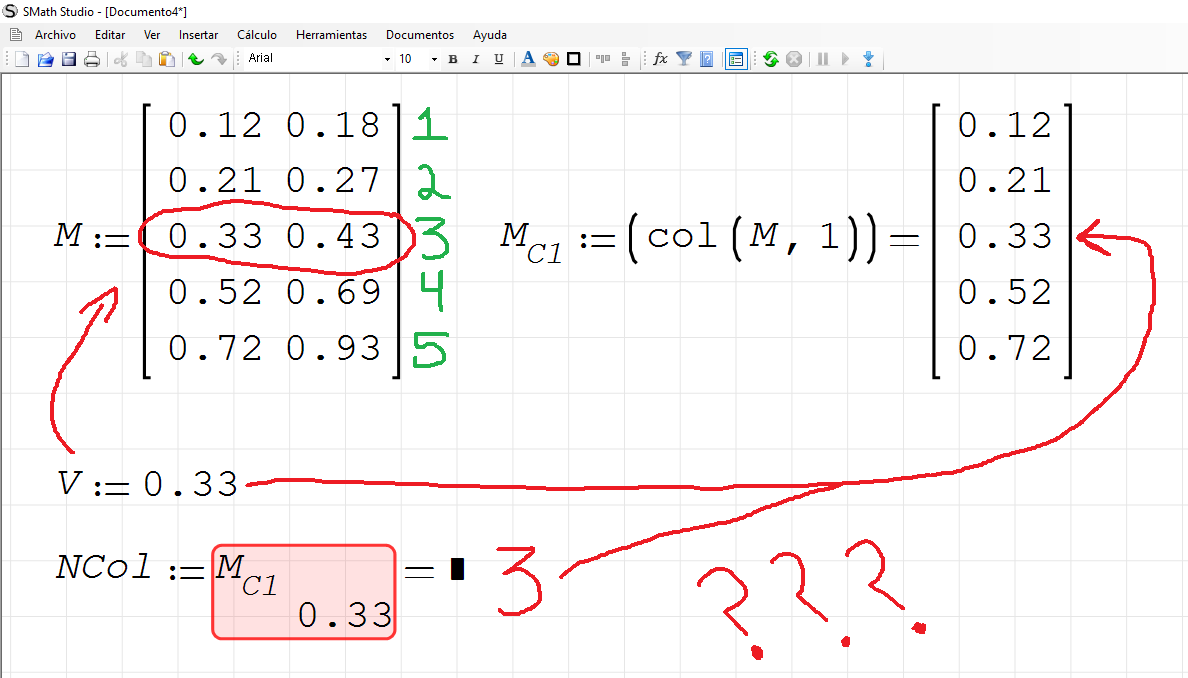

Hi guys
Do you know how to get the number of a row in an array?
ie I have a 5 * 2 array, I want to know what is the number of a particular row
¿Cómo se obtiene el número de una fila, de una matriz?
How do you get the number of a row, of a matrix?
I do not speak English, I hope you can understand me with the following image

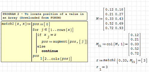

#3 Posted: 3/27/2021 7:32:48 AM
To find the indices of an array of values.
Cheers.....

#4 Posted: 3/27/2021 8:33:47 AM
WroteDo you know how to get the number of a row in an array?
These 4 are from a much larger compendium.
You will go a long route with them.
Utilities Matrix Truth Table [Locate row_col].sm (45.47 KiB) downloaded 1349 time(s).
Utilities Matrix Locate Array1 Array2.sm (70.25 KiB) downloaded 1556 time(s).
Utilities Matrix Truth Table [Locate row_col] COMPANION.sm (153.6 KiB) downloaded 1455 time(s).
Utilities Matrix Treasury_1.sm (423.07 KiB) downloaded 1603 time(s).

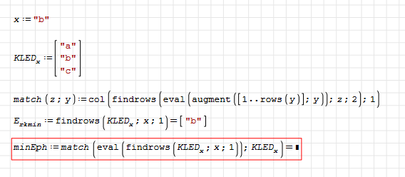

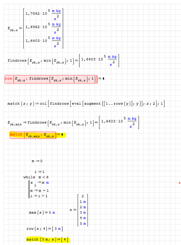

Wrotehey,
i have a some problem.
i hope someone can solve this problem too.
in the first exampe "match" its not working but in the second example it works. i dont know why
Hi Beyaz,
For first warning, row() expect a real pure number for second argument.
Your findrows() result is a number with N unit.
Due to your second problem;
I think commas in your subscripts makes the bug.
When they are deleted, your function match() works.
PS: Please provide your problematic file next time.
Rewriting your entire screenshot is cumbersome.
match.sm (10.75 KiB) downloaded 1515 time(s).

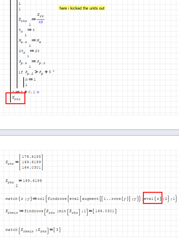

#11 Posted: 7/28/2023 4:32:39 PM
WroteWrotehey,
Hi Beyaz,
thanks overlord
sorry, you are right, next time i will add the file.
i tried it but it doesnt work. this time i add the file.
vogt.sm (636.54 KiB) downloaded 1656 time(s).
//I solved it like this

Attach an image of a typical 6 x 4 matrix 4 decimals.
From there, say what you want to extract.
That will ease the guidance, while avoiding confusion.

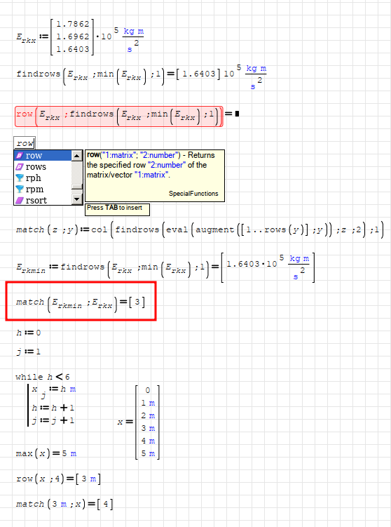

#14 Posted: 1/5/2024 4:37:40 PM
#15 Posted: 1/6/2024 3:48:08 AM
The result of findrows() is a matrix, even if there is only one match (exept for no matches, then the result is the number zero)
Converting it to a scalar, seems to help. The same could be applied to the overall result to remove the matrix.
Yet, there is a shorter way to get the index. This, however, won't work for multiple matches.
