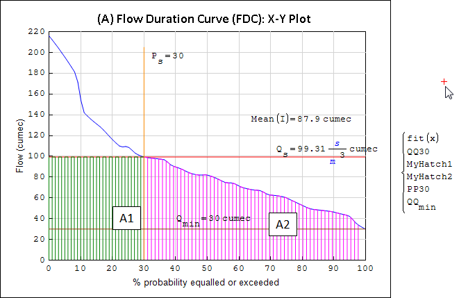

Thank you Andrey for the latest SS: appVersion(4)="0.98.6580.5367" dated 06/01/2018.
Now I am unable to run all my SS files that use ZedGraph plug-in, and one such file is attached please.
Hydro Power Estimation-Wilson Ex 6.11.sm (207.32 KiB) downloaded 1329 time(s).

Thanks Andrey! With your Option 2, it works now with most of the problematic files, except the one which was attached.
I have to check it.

It works here 6179. There it seems it does not like units in cinterp
Your hatch seems damaged as well ... so sorry for the mess I did.
Hydro Power Estimation-Wilson Ex 6.11 fix.sm (229.23 KiB) downloaded 1374 time(s).
You are correct. My file was damaged, but I don't know why.
Thank you.
Thank you.
This happens, it did as well with Mathcad, was never explained.
Most curiously, it may happen after re-opening next day for a new session,
but from observation, it may happen several days. Does it have to do with
the Win update ? Ask Watson.
Once you have created the data set, indirectly it creates noise, because
it comes from collected data. For best result, integrate the data set
from finite differences, not from any interpolated reconstruction.
The finite differences integrator is the most powerful data smoother.
Trust me, I have tested from pure functions, made noisy.
As a result of the noisy data set, you can apply smoothing from ksmooth.
Doing so, you can reconstruct a derivative that makes sense.
That's what I did in the attached.
Hydro Power Estimation-Wilson Ex 6.11 Data.sm (41.54 KiB) downloaded 1341 time(s).
