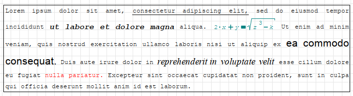

The main features I need to produce professional looking reports though is rich text formatting and spell check. Because of this, I use the "Writer Region" plugin by Davide Carpi for all text and never use the standard "Text region."
I thought I'd throw it out there and see if most people would agree to integrate "Writer Region" to replace "Text region" or add all of the features of "Writer Region."

Writer Region is more advanced,
splendid to highlight parts of project.
But too much when not needed, IMHO.
Both styles Text & Writer accommodate
inserting live maths project inside the region.
Very convenient as it may resume pages of project.
Simply complementary companions at will.
Features like font options, alignment, line spacing imlpemented to text region.
You can even insert formulas in it. It will be a calculation if you want.
Yet there are also useful features not implemented to it.

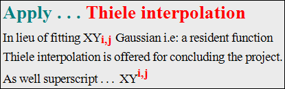

Spell check is missing, also subscripting and superscripting.
You can't make lists inside or indent a paragraph, etc.
Some may need the features of Writer Region, some may not.
In past, I used it for some page design and font variations.
But improvements already made into text region are enough for me.
Nowadays, I don't even need Writer Region. I never use it.
I just keep it when I look into other users sheets.
Changing Text Region to Writer Region would create problem for backward compatibility.
I think most users only used Text Region. Some worksheets may not be opened if replaced by Writer Region.
I would vote for adding missing features. I think that will be more convenience and appropriate.

Writer Region SS 6179 supports subscript/upper-script.
