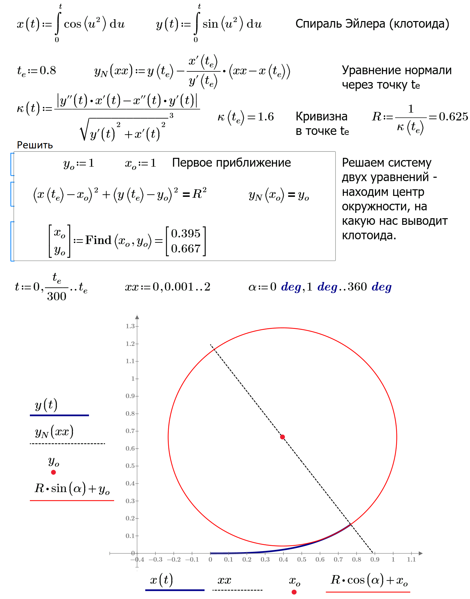

How can I do it in SMath

Hi Valery. This could be a way.
Euler-Spiral.sm (23.92 KiB) downloaded 1680 time(s).

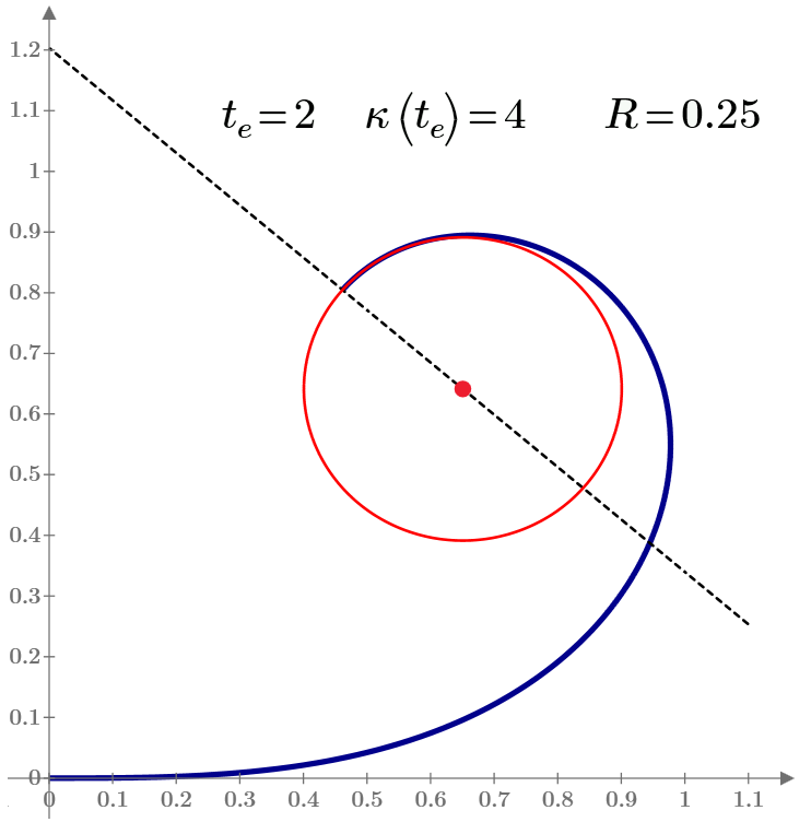

#3 Posted: 5/22/2025 3:48:34 AM
1,139 likes in 1,805 posts.
Animating.
Euler-Spiral Forum.sm (33.9 KiB) downloaded 1666 time(s).
