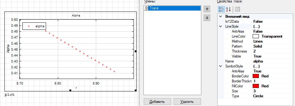

See the attached files. The MANHATTAN DATA.xlsx file is needed as input to LITTLE BOY LAMBDA AND ALPHA.sm.
The calculations seem to be working, but the XY plots are empty.
Have I missed something obvious?

It looks like the plots are empty because they are out of the display range set for the graph.
As it is the X values are actually between 8.75 and 8.95 but the display range is between 0.87 and 0.9.

Hi Reg. In addition to Gerry's observation, by double clicking on the XYPlot, in the "traces" menu, "Visible" is set to "False". The "Visible" property must be set to "True". I don't know how to configure the graph to only show shapes without the line that joins them, without modifying the argument with augment( alpha , "o" ) or something similar.

Everyone,
Thanks much.
At 81, I am clearly losing my mind, or my eyesight...maybe both.
Attached is a pdf of my updated file. All is working now, thanks to you.
