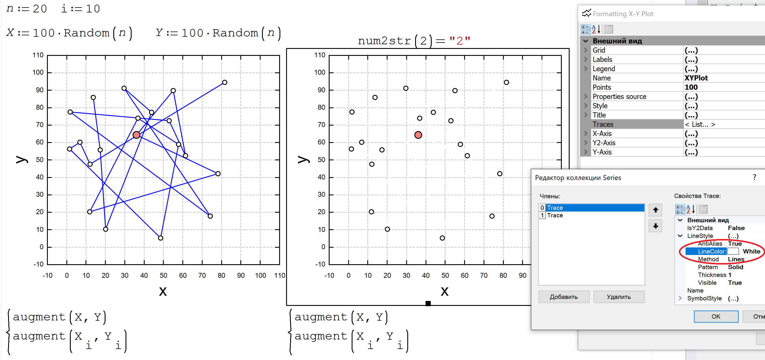

I can only remove the blue lines by making them white.
Is this my defect or the SMath defect?

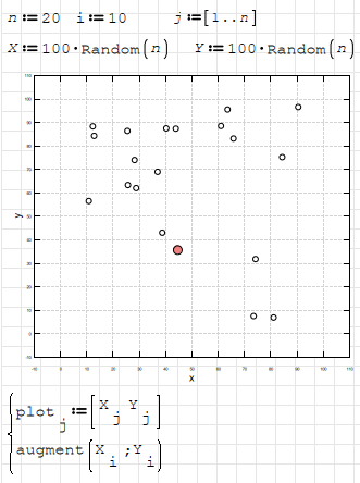

You make your plot a segment of lines by using augment(X;Y).
Make every element individual if you want them as dots.

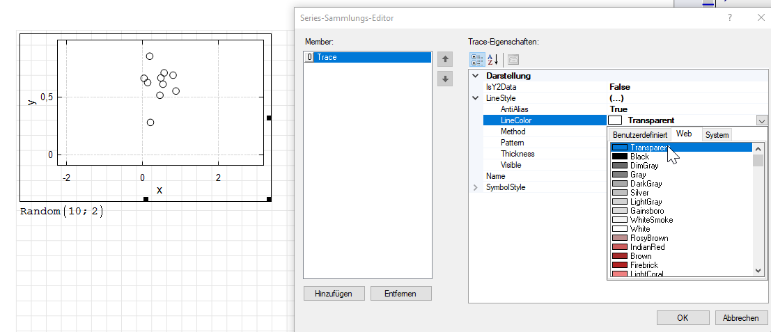

You can set the line color of any trace (input object) to transparent:
