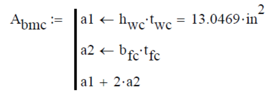

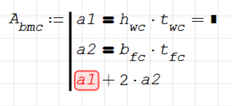

SMath Forum SMath Studio Questions Need Simple Programming Assistance 1 Pages (3 items) Need Simple Programming Assistance - Trying to understand the use of the "break" to create a multistep calculation. - Messages Go to last post #1 Posted: 5/11/2026 2:20:29 AM Robert Stricker 0 likes in 2 posts. Group: User I have used Mathcad for many years, and am now trying to convert my worksheets to SMath.I have the following that works in Mathcad: This is my attempt to recreate this command in SMath: Obviously, I've got something that isn't done right. I would appreciate any assistance in understanding how this is supposed to work. Thank you. #2 Posted: 5/11/2026 6:51:11 AM StvMath 43 likes and 1 dislikes in 70 posts. Group: User Use assignment equals: #3 Posted: 5/11/2026 9:39:32 AM Robert Stricker 0 likes in 2 posts. Group: User Thank you! Works perfectly. 1 Pages (3 items) New Posts No New Posts
