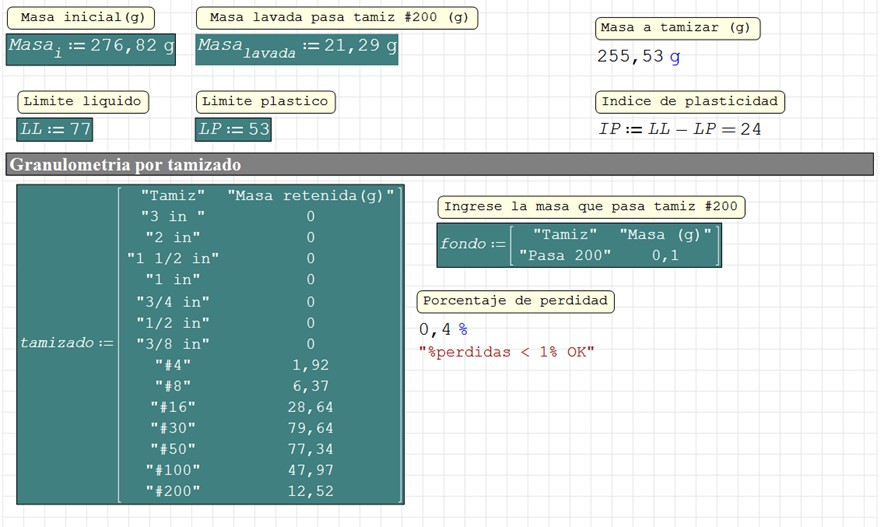

Attached is a spreadsheet to classify the soil according to USCS and the granulometric curve is plotted by sieving.
Please upload any improvements done to this file and post if any mistakes are found or if you have any suggestions.
This is the original code.
USCS1.sm (101.6 KiB) downloaded 1808 time(s).
This is the original code with another particle-size distribution
USCS.sm (103.17 KiB) downloaded 2177 time(s).

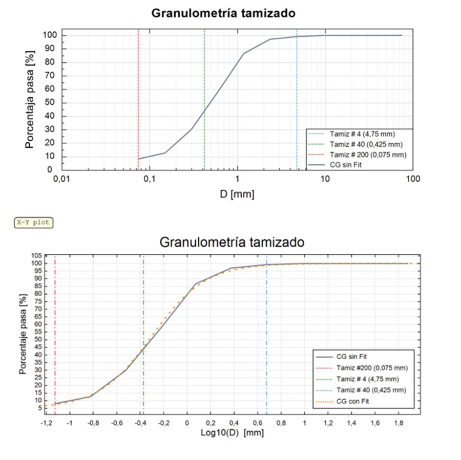

WroteFit & explorer ... Jean
USCS fit Granulometry.sm (21.61 KiB) downloaded 1741 time(s).

I added the logistic sigmoid function you made to the initial code and it compare with and without the fit. In addition to the initial curve, I graphed it using the Zed Graph, where it can be better appreciated using a semilogx graph
USCS-fit-Granulometry.sm (175.97 KiB) downloaded 1634 time(s).
