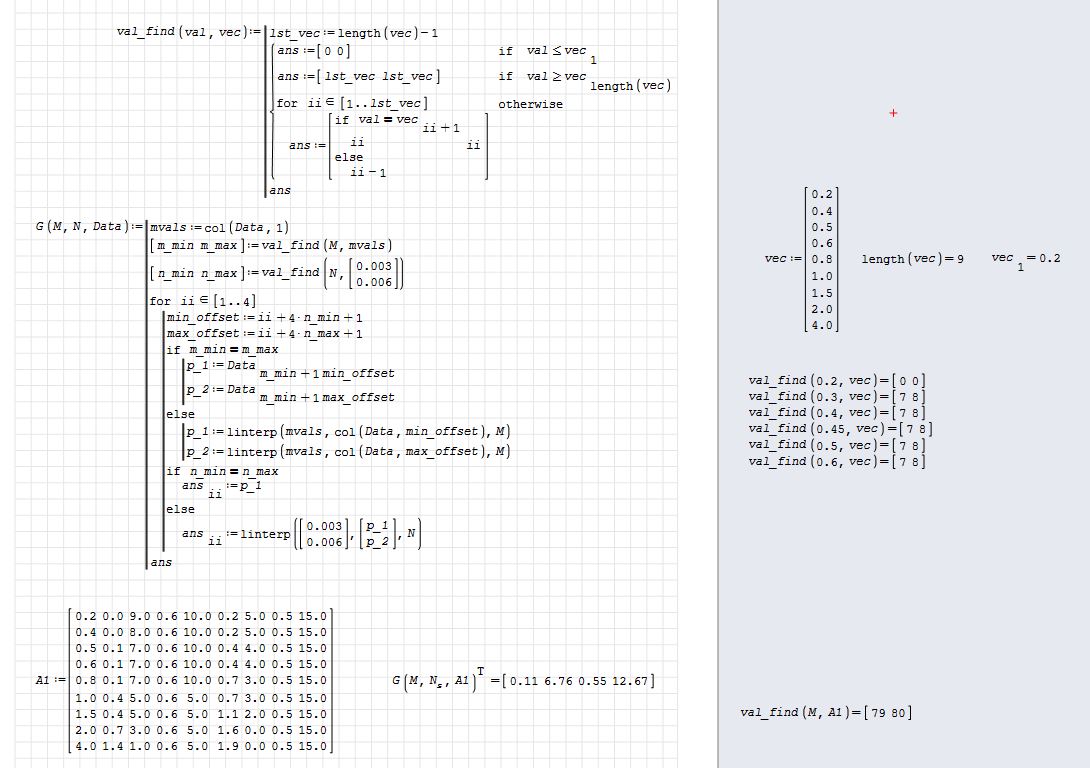

I've have a loop interpolating and searching for values. I not sure what went wrong, the loop is suppose to return 4 answer, however I am only getting (1), the last value.
Appreaciate some help and guidane.

#2 Posted: 1/27/2021 8:27:26 PM
Sorry Collab, I don't understand what you are interpolating.

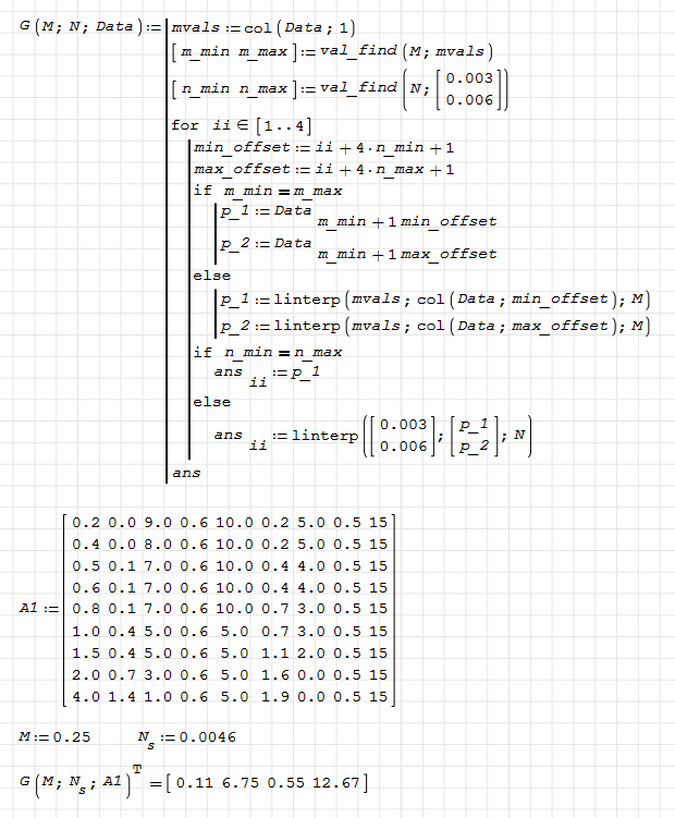

#3 Posted: 1/27/2021 9:48:48 PM
600 likes in 1,381 posts.
Page7.sm (45.9 KiB) downloaded 1410 time(s).
Below you can find corrected file.
I have revised some equations in var_file() and G().
They were trying to reach out of matrix.
Since I don't have original mathcad file this is best I can do.
I did some error check but maybe you have to dig further.

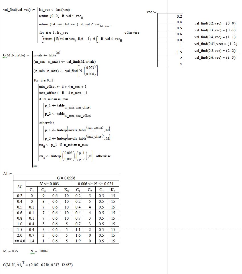

Hi Overlord,
Thanks for the reply. Although the val_file() is not returning the same answer as per the attached MathCAD but the overall loop actual works.
See attached calculation in mathcad.
Page 7.xmcd (97.02 KiB) downloaded 1521 time(s).

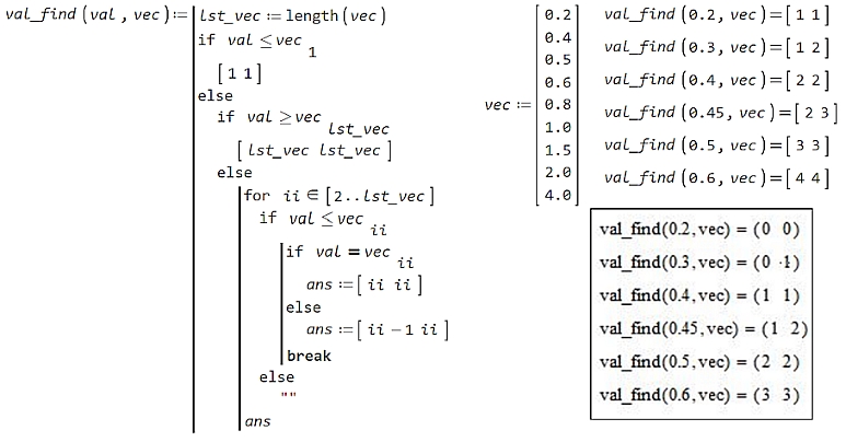

#5 Posted: 1/28/2021 9:23:25 AM
1,139 likes in 1,805 posts.
Hi Overlord,
Hi. val_find() returns the vector index, so it must to be the mathcad answer plus one, because ORIGIN:=0 in mathcad.
val_find.sm (134.2 KiB) downloaded 1248 time(s).

#8 Posted: 1/28/2021 10:54:19 AM
Hi Overlord,
Having the mathcad file revealed the difference of two programs.
The problem is n_min and n_max in smath version.
Mathcad assigns them [0 0], [0 1] and [1 1] only, whatever you enter.
min_offset and max_offset can be calculated within bounds of 9x9 matrix by them.
By that, offsets are always lower then 9 during max_offset=ii*n_max+1.
Your current smath function will produce out of matrix.
Because n_min and n_max are [1 1], [1 2] and [2 2].
And by adding ii to them it will be bigger than 9.
Algorithm should be revised with respect to that.
n_min and n_max should be lowered by 1 to correct it.
You can find re-revised file according to this.
If anything is unusual you can tell, we will try to fix it.
Page7_re-revised.sm (47.13 KiB) downloaded 1391 time(s).
