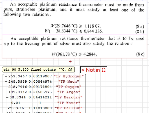

Please, make the attached as you think it should be.
Publish for the benefit of the Smath Community.
Take care Alvaro ... Jean.
Inst_Type Pt100 BIPM Copy.sm (396.81 KiB) downloaded 1801 time(s).

Fedeghi is right, answering you does not make any difference: "Sostenedlla y no enmendadlla". I'm just doing it to warn the community of what I consider to be correctable mistakes but unacceptable bugs if you insist on them.
W is dimensionless, but you insist on putting it in ohms. If you don't want to read the NIST document, at least take a look at the table header: It has no units. Just modify your calculations or stop spamming these kinds of errors:
And don't try to confuse the reader with the 0.01 W value, which is dimensionless and not in ohms like in your table: PT100 temperature sensors have a resistance of 100 ohms at 0 C, not 1 ohm like in your calculations.
Again 0.01°C
eit90 and BIPM are compatible as given conjointly.
Produce your own for the benefit of Smath Community.
Again 0.01°C
Neither, as usual. Sostenedlla y no enmendadlla.
Water TP is the water Triple Point, which is 0.01 C according to ITS-90. You can check that even on wikipedia. The water is for the thermal bath where the sensor is immersed, just like mercury or nitrogen.
PT100 is for Platinum, which has according to EN 60 751 a nominal value of 100.000 Ω at 0°C.
For what? The calculations you show are for the sensor manufacturer, not for use by the instrument engineer to calibrate the sensor. Or do you suggest that I do a liquid Hydrogen or Helium bath every time I'm going to calibrate a temperature sensor?
