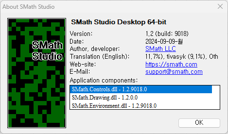

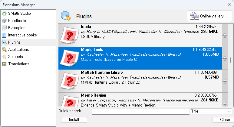

Hello everyone.
i heard that Maple Tools plugin is updated.
I uninstalled the old version before installing the new one.
I'm trying to install the new version, but I keep getting an error.
Below is a video recording of the issue.
https://youtu.be/mwPSEaekRKc?si=5_cvkdZ4CiSZO12D
what is the problem?
Matlab Runtime Library plugin also can not install.

Running the Visual Studio Debugger on a random plugin while trying to install maple tools, I get the following error:
System.IO.IOException: 'Central directory currently does not exist'

Same issue happens downloading other extensions (see crash on download of Interactive Books). Not a Maple plugin issue.
#7 Posted: 10/22/2024 5:11:43 PM
1,443 likes in 2,935 posts.
Seems fixed.
