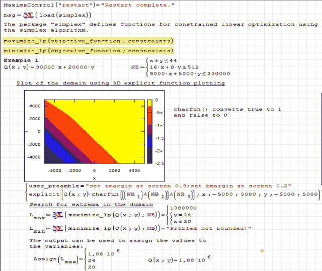

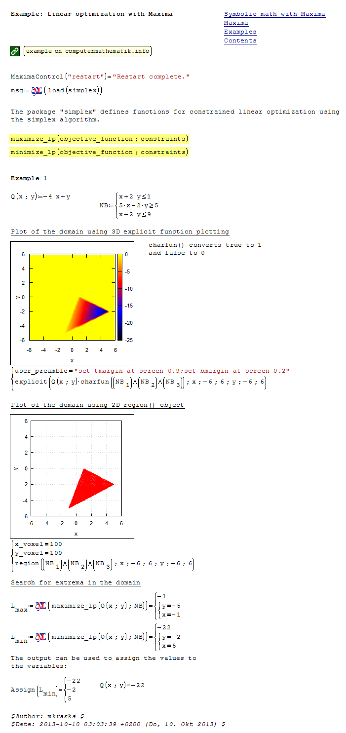

You can use the "simplex" package in Maxima (linear optimization)
See page Examples> Maxima usage> Linear optimization in the interactive handbook.
Example maxima linear optimization.sm (41.89 KiB) downloaded 1179 time(s).

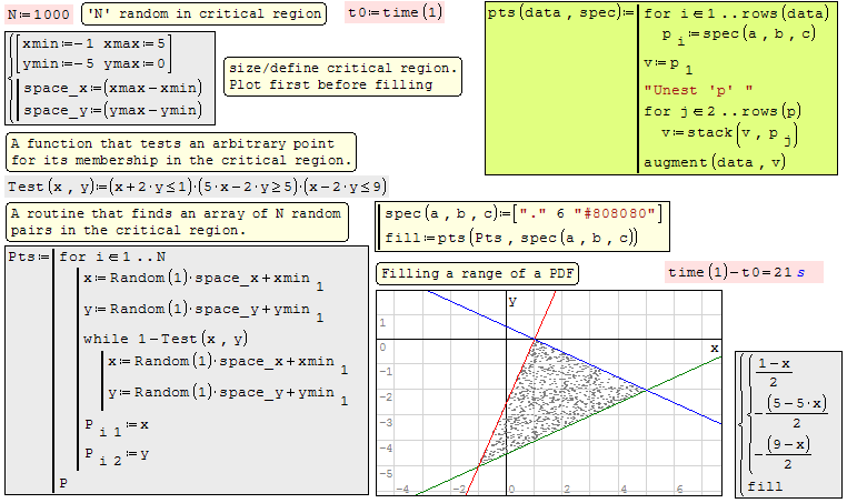

Maybe plot the problem 1rst ?
Next solve solely with Smath, whereas Maxima is not component of stable 6179.

Here is + some extra stuff. Maybe there is way to draw an inscribed 3D ?
Solve GivenFind Critical Region Copy.sm (39.35 KiB) downloaded 1210 time(s).

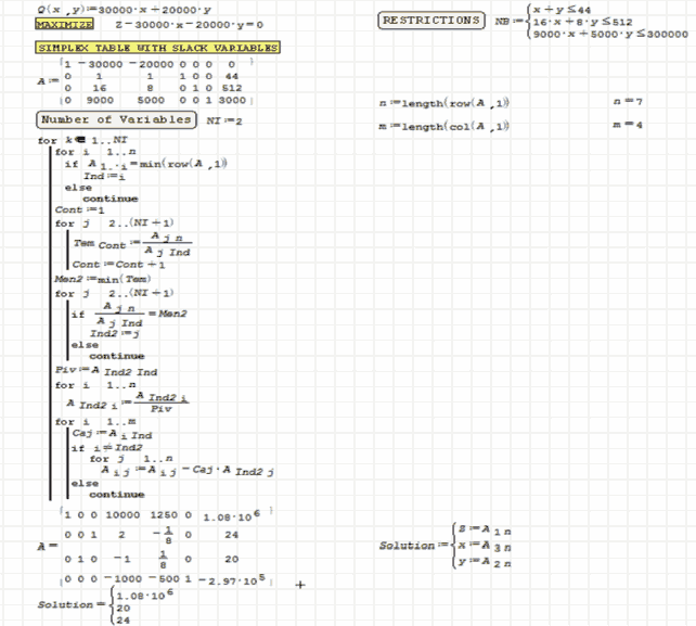

Using Smath Studio with Maxima and the example of Martin Kraska.
Metodo_Simplex.sm (52.26 KiB) downloaded 1209 time(s).

Here is a small and simple Simplex algorithm without the use of the Maxima function.
Small_Simplex_Algorithm.sm (16.35 KiB) downloaded 1236 time(s).
CAUTION: The algorithm is NOT TESTED, but it works well for this example.

A little Simplex algorithm improved
Small_Simplex_Algorithm_Improved.sm (88.5 KiB) downloaded 1184 time(s).

I'm sorry, I found a bug in the Simplex algorithm.
Now it's fixed.
Small_Simplex_Algorithm_Improved_2.sm (135.66 KiB) downloaded 1211 time(s).

Thanks Jean, Now we just have to continue testing the Simplex algorithm, to identify possible faults.
regards
