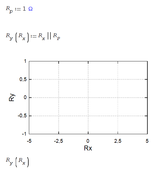

I am trying to plot electrical resistance using Electrical Engineering Library and X-Y-Plots Plugins but it does not seem to work:
Can anyone help me plot this?

Delete the ohm unit in Rp.
Usually you shouldn't use units while plotting.
For information, this includes most numeric solver functions too.

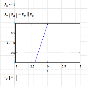

#3 Posted: 10/16/2021 7:46:20 PM
599 likes in 1,380 posts.
Or if you will really need units;
Try to eliminate or add them in the input data.
It is to avoid them being used in plot.
Or to avoid conflict between unit-ed numbers and not unit-ed.
When you use Rx in your function, it can't be EEL_par with 1 ohm.
Plot try to use Rx as an number not a unit added number.
You either add unit to Rx or do opposite.
Opposite is eliminating all units of other variables.

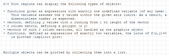

#5 Posted: 10/17/2021 2:28:23 PM
Thanks, this makes total sense.
Also, how is it possible to only plot (or "stem" as it is called in Matlab ) integer values?
Maybe I chose a wrong word to describe it, shall edit.
It will plot not only integers, numbers actually.
But plot expect them to be dimensionless.
Not just X-Y plot, built-in 2D plot also.

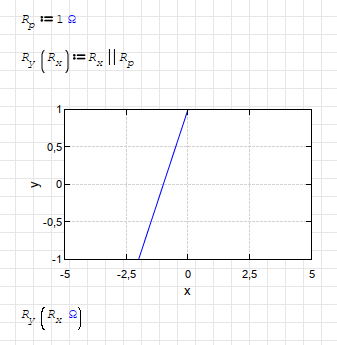

#7 Posted: 10/17/2021 4:23:47 PM
So how did you add the Ohm symbol under the plot? It won't let me add a unit there.
1 - Hit multiply after Rx;
2 - (Type W in place holder, place Ctrl+G) or (Click ohm from right pane);
3 - Placeholder shall appear, either double click or press tab to insert Ω as unit.
If you are not typing units after numbers, this is the way.
You can also type ' between step1 and step2.
Units can be typed or chosed with this way more quick.
This will directly open placeholder scroll menu.

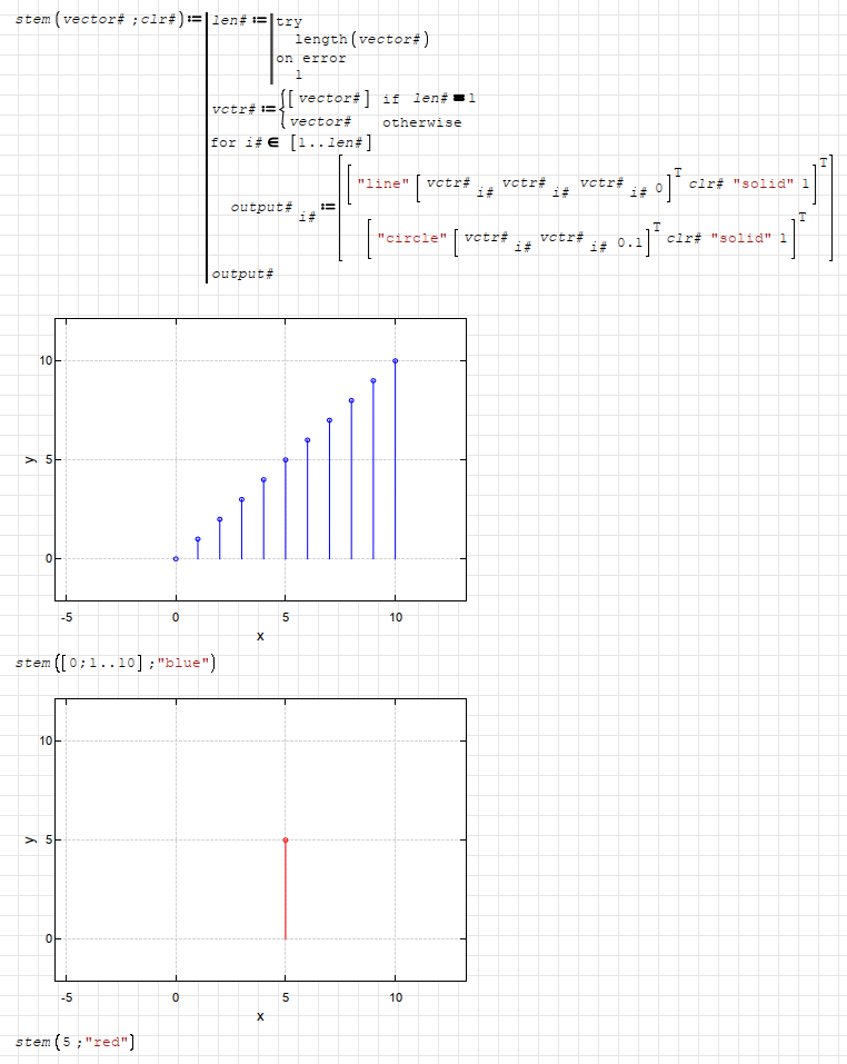

#10 Posted: 10/18/2021 5:05:53 PM
I don't know if there is a stem equivalent for smath plots.
But you can create your own function for that purpose.
stem.sm (8.62 KiB) downloaded 1191 time(s).

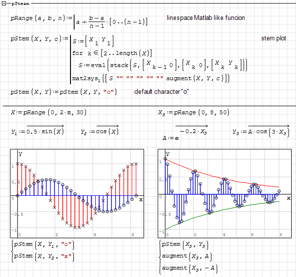

#11 Posted: 10/18/2021 9:03:39 PM
... you can animate the stem system, have symbols too.
Here, integers are the X direction.
Eventually, easy for the Y direction as applicable.
2D Util Stem ANIM Laplace Diffusion.sm (21.6 KiB) downloaded 1231 time(s).
#12 Posted: 10/19/2021 12:42:00 AM
1,134 likes in 1,804 posts.
Hi. In addition to the overlord solution, this is another approach.
stem.sm (12.15 KiB) downloaded 1156 time(s).

#14 Posted: 10/19/2021 11:19:27 AM
...In addition to the overlord solution...
Mine was not a solution to be honest.
Just a quick and ugly way to show it is possible.
This is a good solution though.
