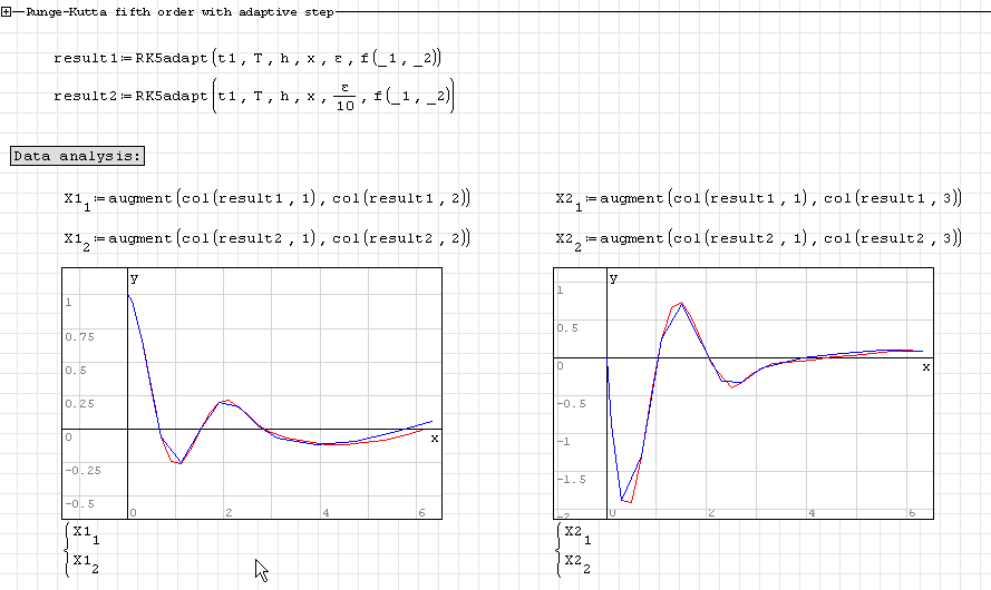

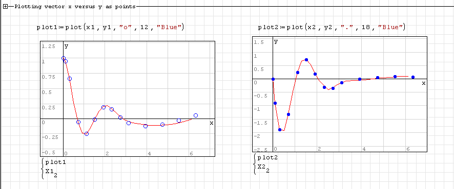

Hello Andrey,
Here is a simple example to show how multiline (programming) function, snippets and Area regions have given quite a significant improvement to SMath.
I just used your Runge-Kutta fifth order example and made a multiline function. Then I make a file and snippet from it
Here it is RKadapt.sm. I used the snippet and, just for testing, make two callings of the function (different precission) - here is the picture:
Then, I made a function and snippet for plotting points - here it is plot.sm
Here is the picture:
The final file I was playing with is here RungeKutta5-1.sm
This is great!!!
P.S. When making snippets for the portable version, the snippets are lost from the snippets manager after restarting SMath. I did not figure out how to keep them there.
