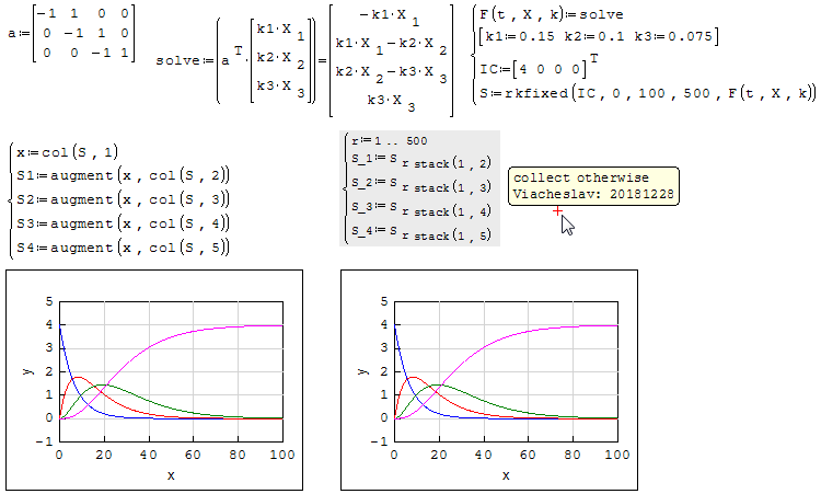

The link to the extracted:
http://twt.mpei.ac.ru/TTHB/1/Chem-Kin-Chapter-3.pdf
ODE rkfixed Chem_kin Parametric_0.sm (97.28 KiB) downloaded 1351 time(s).
ODE rkfixed Chem_kin Parametric_1.sm (148.89 KiB) downloaded 1317 time(s).
