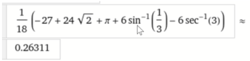

Why SMath studio does not give at least the correct result which is 0.263 for this integral?

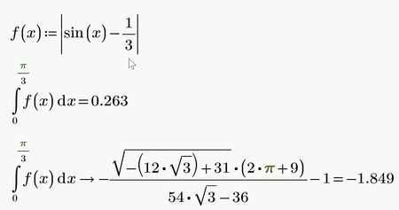

Mathcad Prime 10:
-1.849 result is comming from symbolic result calculation, which is wrong in this case, but numeric result 0.263 is correct here also in mathcad prime 10.

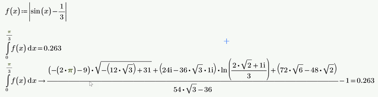

Mathcad Prime 6:

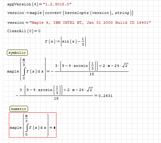

SMath Studio:
Wolfram mathematica:

You must clear previous results (implicit definitions). If you do not, the task statement may change. To be sure, do each check separately in a new document.

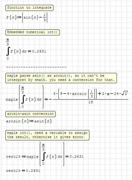

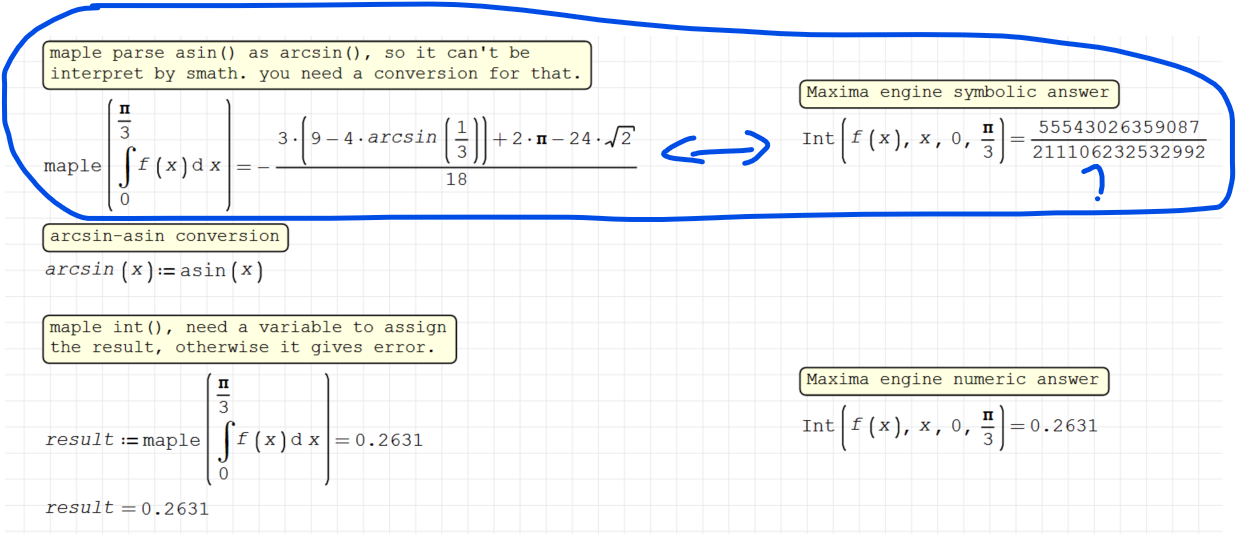

It gives correct results, even with embedded or maple.
You need to change arcsin() function to asin() however.

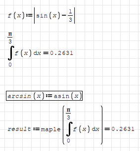

Could you post also the worksheet? As I do not know why my function arcsin(x) definition is not taken into account
Here it is, regards
int-embedded_maple.sm (6.97 KiB) downloaded 1695 time(s).

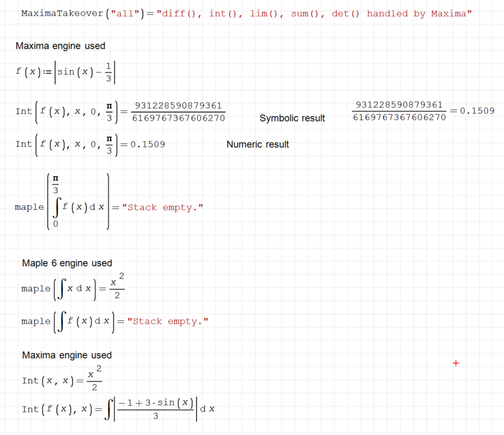

I see also the difference between Maxima engine and maple version 6 engine (in symbolic answer). With maxima engine the result is more a rational approximation of an irrational result. I would expected something similar as maple engine give when evaluating integral symbolically.

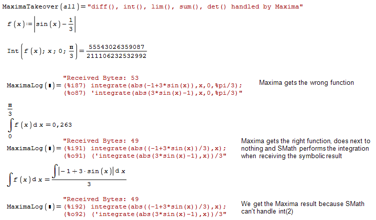

Maxima can't handle the integral. It returns a slightly modified symbolic representation. This is hidden by SMath postprocessing of the symbolic results (which doesn't seem to be suppressed for Optimization> None.
There seems to be a problem in preprocessing/translation when using the Int() function.
Worksheet20.sm (7.27 KiB) downloaded 1645 time(s).
