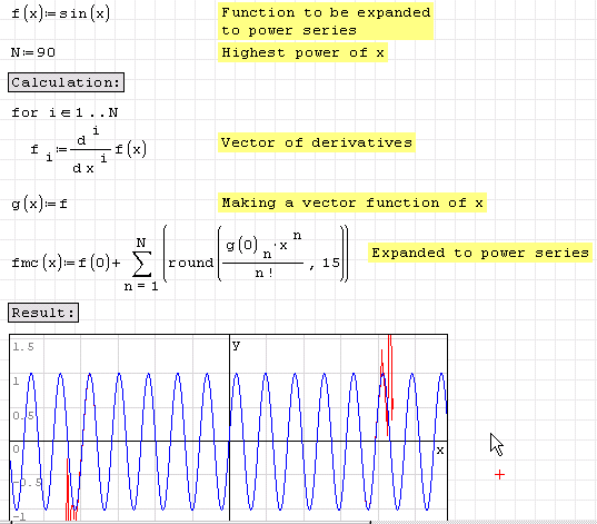

If you remember, "eval" function has been introduced in the case of rather complicated symbolic result resulting in slow calculation. If we need the numerical result only, by using "eval" the calculation time can be reduced drastically. Sometimes "eval" will not help. Here is an example were "round" can aslo help . This is an Example from the SMath included Examples.
(Numerical instability is expected, of course). Without "round" you can use up to 26-th polynomial degree.
PS. It is interesting to note that in this particular case "eval" will drastically increase the computational time. It might be usless (very slow) for higher polynomial degree. I do not know why, but "round" will do do job quite good. Forgot to mention - this is from 0.87 stable version. Could someone check it on 0.87 Beta? I will also check it tomorow at my office.
