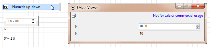

Davide, it seems that description strings of the region are ignored in the viewer. Can that be changed or do I need to use sort of "nice" variable names?
Notenschlüssel.sm (11.53 KiB) downloaded 109 time(s).
#4 Posted: 3/18/2014 7:48:19 PM
I'll do it Martin... previously I've noticed a bug, now seems that the description text it works
#5 Posted: 3/22/2014 1:44:41 PM
UPDATED
(SMath Studio 0.97.5189)
- SMath Viewer: uses the region description (if exist and is shown).

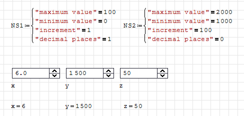

#8 Posted: 10/8/2015 10:36:19 AM
I think it is possible...
Something like in the attachment? The entry point for the variable would be the form (like in table region) or in the context menu (like in the modeller region); this should grant customizable settings for every region, when you have multiple regions.
ioan92 10/8/2015 10:58:00 AM
#9 Posted: 10/28/2015 11:55:55 AM
PLUGIN UPDATED SMath Studio 0.97.5737
- Introduced settings from canvas (see attachment);
- History Undo/Redo now is supported;
canvas settings.sm (17.29 KiB) downloaded 1734 time(s).

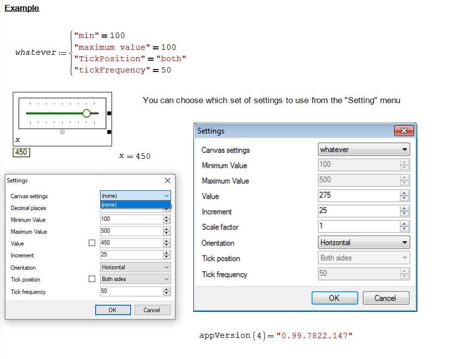

Hi, it seems that the "canvas setting" field does not recognize the "whatever" variable. I'm using smath in windows 10.Slider.png
#14 Posted: 10/25/2021 9:18:43 PM
600 likes in 1,381 posts.
I think this can be a bug.
When a setting has a string value, it can not be read by canvas settings.
Delete the "TickPosition" = "both" and whatever will be readable again.
I have tried this with "orientation" = "vertical", whatever can't be read by canvas settings.
Deleted the "orientation" = "vertical" element, and it can be available again.
This behavior made me to think there is something wrong while reading strings.
#15 Posted: 10/26/2021 5:58:20 AM
Thank you, confirmed. I'll fix it ASAP.
You are right, it is related to strings encoding. If you remove the space character from "maximum value" it works as expected.

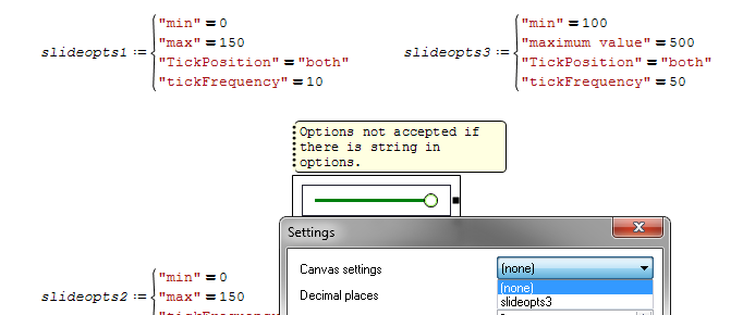

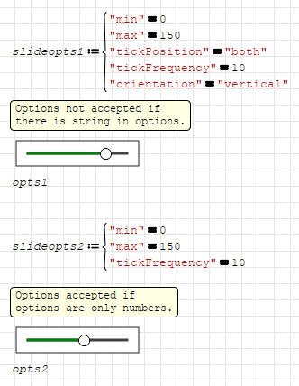

String issue not fixed, at least for linux.
slider_options.sm (4.55 KiB) downloaded 1590 time(s).
#18 Posted: 11/2/2021 5:58:47 AM
Thank you, I can reproduce with your file even in windows... this issue it's something more subtle, though
#19 Posted: 11/2/2021 11:56:10 AM
Found it. You forgot to set the optimization to "none" on definitions, as indicated in the documentation. If you hover over the definition you can see that in both numeric and symbolic optimization the boolean equal between strings is preprocessed and stored as 0.
#20 Posted: 11/2/2021 2:28:13 PM
Thanks, now it works.
