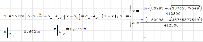

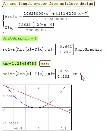

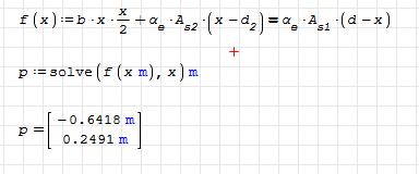

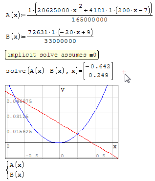

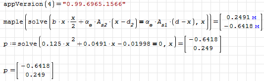

#2 Posted: 1/27/2019 3:05:54 PM
Davide Carpi 1/28/2019 5:53:00 AM
#4 Posted: 1/28/2019 3:56:15 AM
4 users liked this post
NDTM Amarasekera 1/28/2019 7:13:00 AM, sergio 1/28/2019 6:54:00 AM, Davide Carpi 1/28/2019 5:53:00 AM, frapuano 1/28/2019 12:57:00 PM
#6 Posted: 1/28/2019 2:21:38 PM
