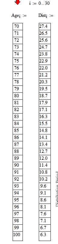

I am a long-time user of Mathcad. I cannot find a way to enter data into Smath. It seems range variables are not the same as in Mathcad. Do I need to enter data into a vector? If so, how do I define the vector of say 30 elements and then proceed to enter data into each of the 30 elements. All documentation provided does not make this clear. See attached image from Mathcad to see what I am trying to implement in Smath.
Thanks

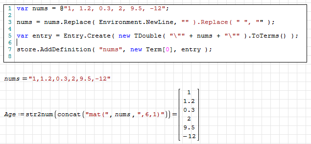

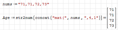

#4 Posted: 2/14/2019 5:29:33 PM
1,544 likes in 1,859 posts.
You can do it like this.
Andrey Ivashov 2/14/2019 6:46:00 PM
#5 Posted: 2/14/2019 5:44:13 PM
More difficult way with using Script region.
