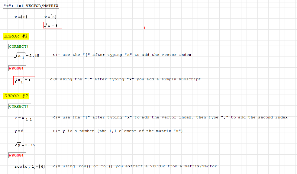

#4 Posted: 5/18/2012 8:52:51 AM
1,442 likes in 2,933 posts.
there are two errors
here is the file in the image: vlookup_debug.zip
regards,
w3b5urf3r
#5 Posted: 5/19/2012 3:45:17 PM
xyonx
xyonx
0 likes in 10 posts.
Quote
use the "[" after typing "x" to add the vector index
thx u for clearly explains the typing method in previously posted by Ommor, it cut down my times and complexity using too much multiple branch
