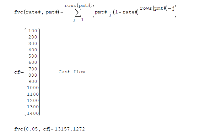

I started getting ambitious and was programming the financial functions in a plugin when I got stumped. How do you program the equation below? The problem is the j value is an index within the sum that identifies which element of the matrix to process at each step. Its a variable of the sum function. The plugin example shown in the wiki uses constants. By that I mean the values are all set and constant when the function is called. For the sum function the j index of the pmt# matrix has to vary.
You can get an idea of how the plugin should be programmed by looking at the SMath sm file using a text editor. But in the sm file j has been typed, is visible on the screen and is in the "Store". For the sum function to work properly in a plugin a new variable has to be created in the plugin program and placed in Store and fed to the sum function. Haven't been able to figure that out.
Any suggestions?
Any suggestions?
Ed

[MATH][/MATH]Using the same Cf as your example, I added a third arguement to fvc. So I have fvc(rate,pmt,n)
Not sure how you displayed your function !
I used fcv(rate, pmt,n):= SUM (from j=1 to n)pmt(sub j)* (1+rate)^(n-j+1)
My result from fvc(0.05,cf,n) was 13,814.98 agrees with an Excel worksheet I used for the same calculation
If there was a function to count size of a vector we could dispense with n
best wishes
fvc(rate,pmt,n)←sum((el(pmt,j)*((1+rate)^{n-j+1})),j,1,n)
How to get this to look like Smath?
best wishes
